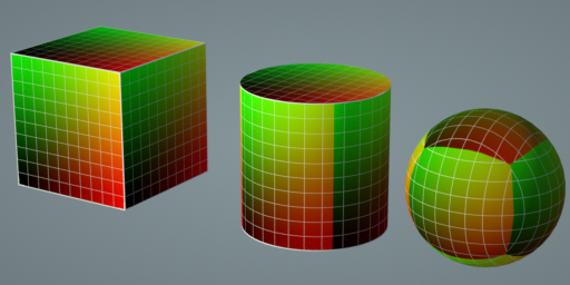

XYZ to UVW
also known as: Planar, Flat mapping
Just take the coordinates in world or object space and use them as UVW coordinates. For images only the X and Y coordinates are relevant, which are mapped to U and V. In other words the images use flat mapping projected along the Z axis.
In 1.30 the projection will map image textures to the (-1, -1)–(1, 1) range. So rotating the mapping around the Z axis will rotate the image around the center, as the UVW rotation would do.

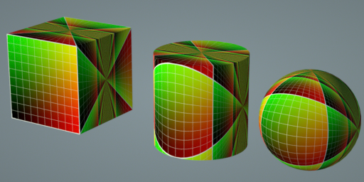

Box
also known as: Cube mapping (although some applications may have a different mapping called Cube mapping)
This is an extension of XYZ to UVW mapping, it will pick a different projection axis depending on the normal. This gives a quick way to map a texture on any object without too much distortion, but possibly with a lot of seams. The same change in mapping applies here: image textures are mapped to the (-1, -1)–(1, 1) range.

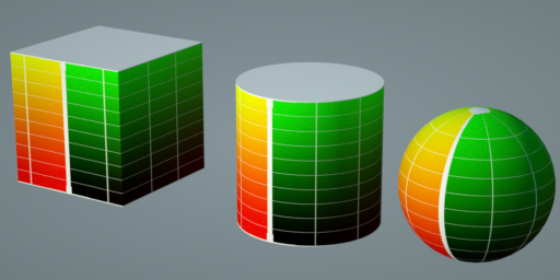

Cylindrical
This performs cylindrical mapping: the U coordinate is the longitude, the Y coordinate is the world space Y coordinate. For images the mapping on the Y axis has changed to map the image to the [-1, 1] interval. For procedural textures the W coordinate is the distance from the Y axis. For points on the ground plane (Y = 0) cylindrical and spherical mapping now map to the same points on the images (what would be the equator on spherical mapping).
