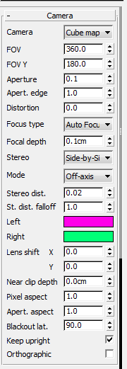

1. Create a Octane Camera, set it to Panoramic, but which mode? Spherical, cylindrical or cube map?
2. Set the Camera to Stereo, but which to mode? Side-by-side?
3. What is the correct render Resolution / aspect Ratio?
4. What app should I use to view the rendered Image/movie?

Here are settings for 3dsmax render resolution is 18432x1536 and aspect ratio 12:1 OCTANE camera. Don`t use post processing effects in camera settings.
