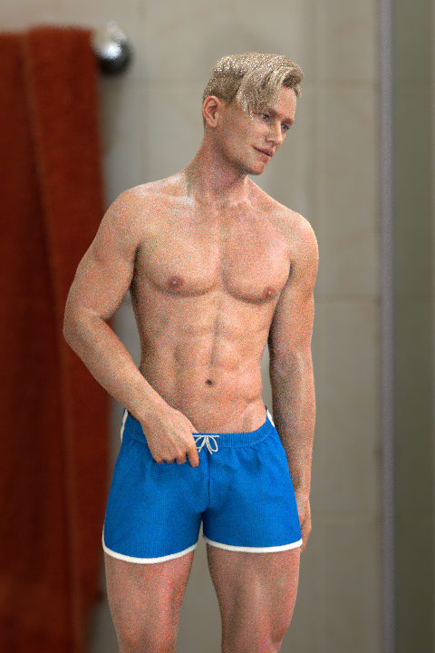

is there a way to make my characters/objects look like they're in an hdri instead of...tiny and out of place? I'm using an 8k image here

This is something I actually know a thing or two about ; )
For this to work you need to somehow 'recreate' the room in which the spherical image was made.
- Your render camera must be in the position where the real camera was in the room: in the centre of the image-sphere, and at the same height above the floor as the real camera was.
So your render camera needs to be at the origin of 3D space, at point 0,0,0
- The floor where you will place your figures and/ or props will have to be lowered accordingly.
If you didn't create the spherical image yourself you will have to guesstimate, but usually about 1.5 meters is about right.
- To help you position your figures and/or props correctly in 3D space in relation to the spherical image, it can be useful to actually place primitive planes of appropriate dimensions in the scene where the floor and walls would have been.
You normally wouldn't render them, but these planes can sometimes also be handy for catching (or casting) shadows.
In short, if at the time of creating the spherical HDR image it would not have been possible for a person to stand between the camera and the wall of the room, then you cannot possibly place a figure in that position in your render without it looking odd (to say the least).
Looking at a 'flat' 360x180 degree image, everything seems too small and far away from the camera.
To get a much better impression of the room (or landscape) you will have to use an interactive viewer for equirectangular images, like DevalVR Player.
Hope this helps, cheers!
Erik

Thank you Erik. I did try what you asked but my stuff still does not look like it "fits" in the scene. I will have to try more experimentation I suppose.
