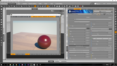

If you create new presets but to not copy them to "My presets" they will only be saved with the current scene.
If you want to have the presets available in all OctaneRender projects you need to copy your presets to "My presets":
- Click on "Copy"
in the appearing menu window
- give your preset an unique name
- place a checkmark in the box "Save to my presets"
-> Now your preset appears in the "my presets" area of the render settings pull down menu.

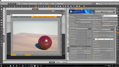

Note: All values in the preset will be greyed out.
This is to make sure that you do not accidentally change any values in the preset.
If you want to alter the preset use "Copy"
This time do NOT activate the checkmark "save into my presets" so you can still edit the values.
