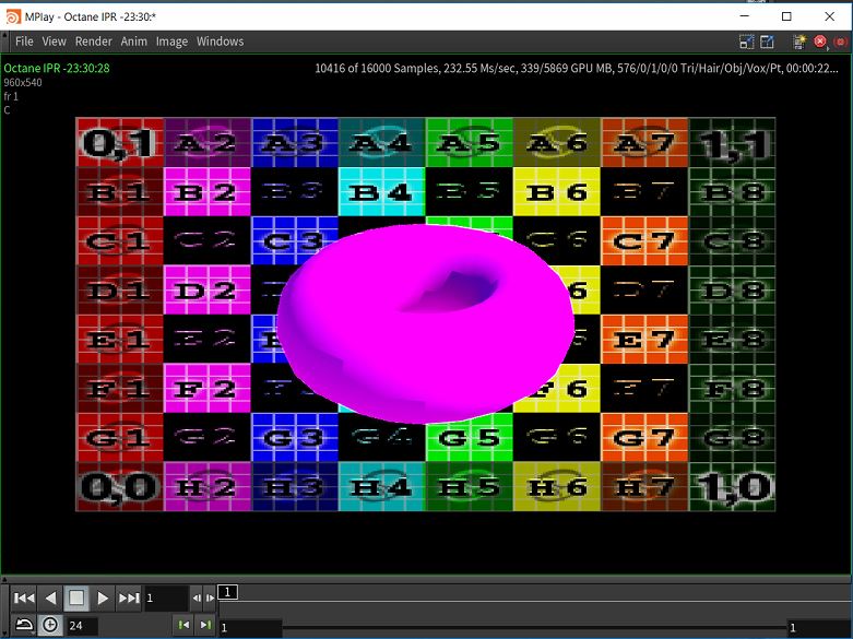

This feature will be available probably once we have ready the new Qt based IPR, but meanwhile, how about using MPlay as IPR viewer when you need to work with background plates? ... I know that the MPlay IPR has some limitations, but on the other hand, it supports the background plate feature without problems.
Thanks,
-Juanjo
