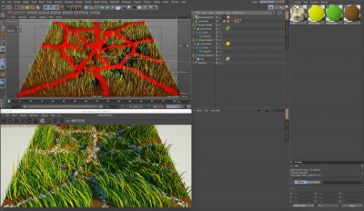

Posts: 10613
Hi AutoactivaGmbH,
do you mean something like this?
ScatterObject.c4d.zip
(387.96 KiB) Downloaded 341 times
ciao beppe
