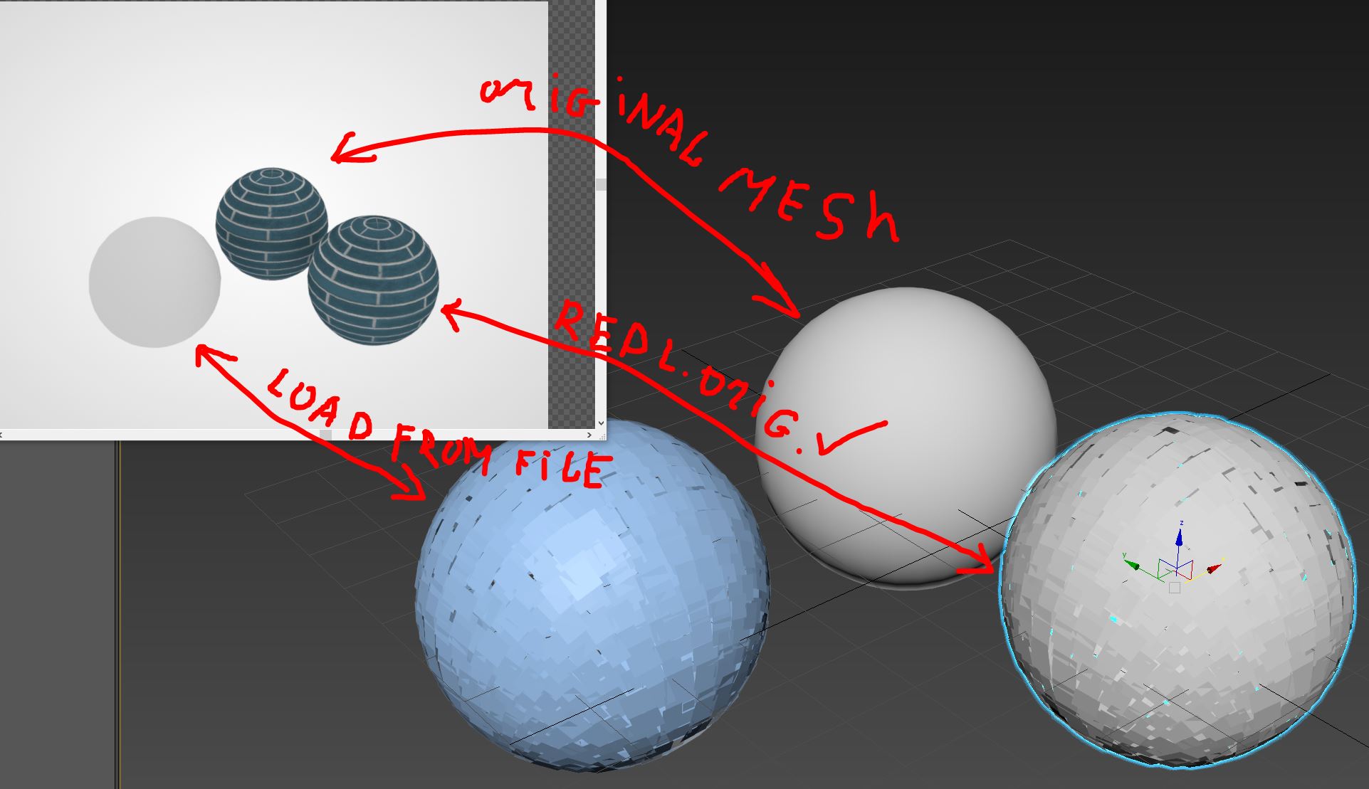

Seems like I've found a bug with proxy in octane for 3ds max 2016. Verion 2.25-2.21 (Windows 10, gtx 780)
Steps to reproduce.
1)create some object
2)Assign octane material to it, with diffuse rgb texture.
3)Right click in viewport>export to octane proxy. Do NOT use "replace original" checkbox.
4)Create new empty octane proxy object, and assign previewsly exported file to it.
If I use checkbox "replace original" then all renders fine, but I can't create empty node, assign proxy file and render with materials.
Please take a look at attached file.
Thanks,
-Pavel

Hm, If from mat editor I assign material to proxy file it renders ok.
So there is another question: does octane store material and texture information in proxy file? I mean can I. for example, use exported from max proxies in maya?

Hi, thank you for reply.
As I understand there are two ways to work with proxy files in 3ds max.
1)From 3ds max I select the mesh that I want to be a proxy, right click on the viewport>export to Octane proxy> set the proxy file patch and enable "Replace original"
2)Do the same things like in 1 but without replacing original mesh.
Why Is the reason to not preplace the original mesh?
Reason 1
For example you have a file with plant library and you want to exportt some plants as proxies to other scene.
Reason 2
You can work on assets in studio and deliver the assets in octane proxy format. For example if someone uses standalone version for final rendering and someone 3ds max version for asset develop and delivery. Or someone uses maya and someone max.
Reason 3
You may prefer to use those proxies in future projects.(in archviz it's very useful.)
So the problem is that when I open a proxy via OctaneProxy node, it doesn' load the materials and textures from proxy. I'm not going to assing new material to existing proxy file, I mean when I load it manualy(replace original checkbox is disabled) it comes without materials.
Thanks again,
Pavel

I see what you mean. I believe that users have reported success with using applications like Forest Pack to handle use cases the likes of which you have outlined. Support for that is still imperfect due to some difficulties the software has with supporting GPU renderers. I will further assess this issue and see if there is anything further we can do. The upcoming Octane 3 has helped to open up a host of new options from a development standpoint that could make a solution to this more feasible than it has been in the past.
Apologies for not having a more favorable response. I will keep this forum posted on any improvements that can be made regarding this issue.
