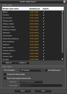

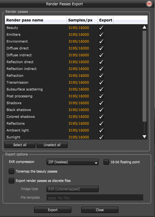

face_off wrote:perhaps I can add it as an option to the Preferences
Yes this has to be optional. The standalone has several options for "render passes export" which I'd love to see in the modo plugin.
