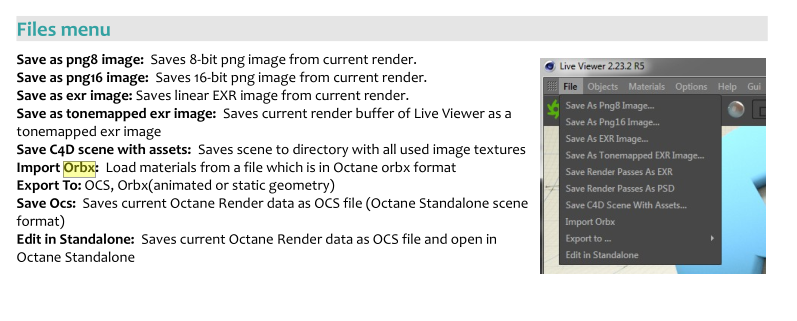

here
Дмитрий.Зерницкий
Posts: 14
Joined: Sat Apr 09, 2016 4:43 am
It's screenshot from C4D plugin, right? I got how to export\inport\edit .orbx
But what if I have standalone and a .orbx animated scene, provided by somebody(I do not have any 3d package). Can I export sequence using Standalone only?

for rendering image sequence in Standalone, use batch rendering:
