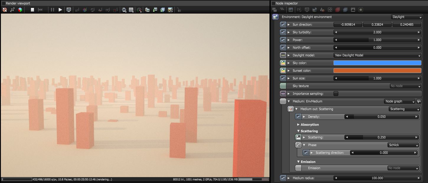

Posts: 10598
Oh sorry, shame on me :(
I have prepared a simple scene some days ago but i have forgot to share it :?
Basically you have to play with higher Phase values, here is the example:
FogTest.7z
(128.49 KiB) Downloaded 532 times
ciao beppe
coilbook
Posts: 3162
Where can we find phase values in 3ds Max to create thicker fog farther the o next is,?
Posts: 10598
Hi coilbook,
you have to add a scatter node in the medium slot in the Daylight, and then add a Schlick node in the Phase slot:
ciao beppe
