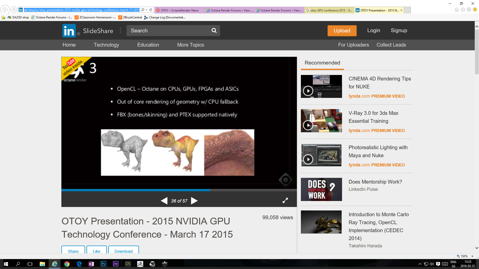

- linvanchene
- Posts: 783
- Joined: Mon Mar 25, 2013 10:58 pm
- Location: Switzerland
It was not a stupid question at all. I also do not think anyone is making fun of you or the question. People may just be hinting at some latest rumors.morphious2013 wrote:Stupid question get stupid answer. Ha ha. It was early and before my morning coffee. So there.......
The answer to the question changed during the last year. Not everyone may be familiar with the progress in this area or follow all the rumor threads spread across the forum.
Overview from GTC 2015 to rumors pre GTC 2016
At the CPU Technology conference in 2015 on slide 36 you can read that OpenCL, CPU and out of core geometry was indicated as an area of interest for possible development.
source:
http://www.slideshare.net/otoyinc/otoy- ... ch-17-2015
slide shown at 11:32
https://www.youtube.com/watch?v=mHKmqWwEGxQ
-> Source of the confusion may be that GTC announcements are not facts but rather a message of intent. Actual development focus may change during the course of the year if roadblocks are hit or other opportunities present themselves.
During the first OR 3 development builds it became clear that OpenCL, CPU support and out of core geometry have to be put on hold.
viewtopic.php?f=33&t=51679&hilit=opencl ... 60#p265316
Based on the latest rumors it seems like Otoy has changed development focus on a different area:
-> Instead of focusing on OpenCL, CPU and out of core geometry a lot of time and energy seems to have been invested to
make CUDA work on many different plattforms .
