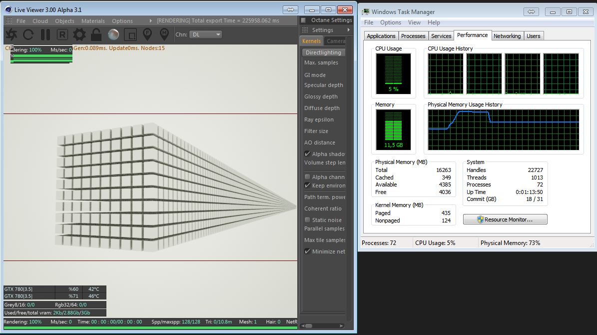

Here is a simple scene that almost grows by 1M for every rows of the upper mograph cloner:

I have 4 Titan X, 12 Vram each, but, I just see the amount of ram of one card on the render info, why is that ?
I believe that most of my vram usage is on the textures, both things goes together. just 3 million triangles.

Work with V3 Alpha6.1.
Of course textures will eat some vram until your VRAM filled. If you enabled "out of core" they will be used from RAM after VRAM is unsufficient. Compare your scene without textures.
