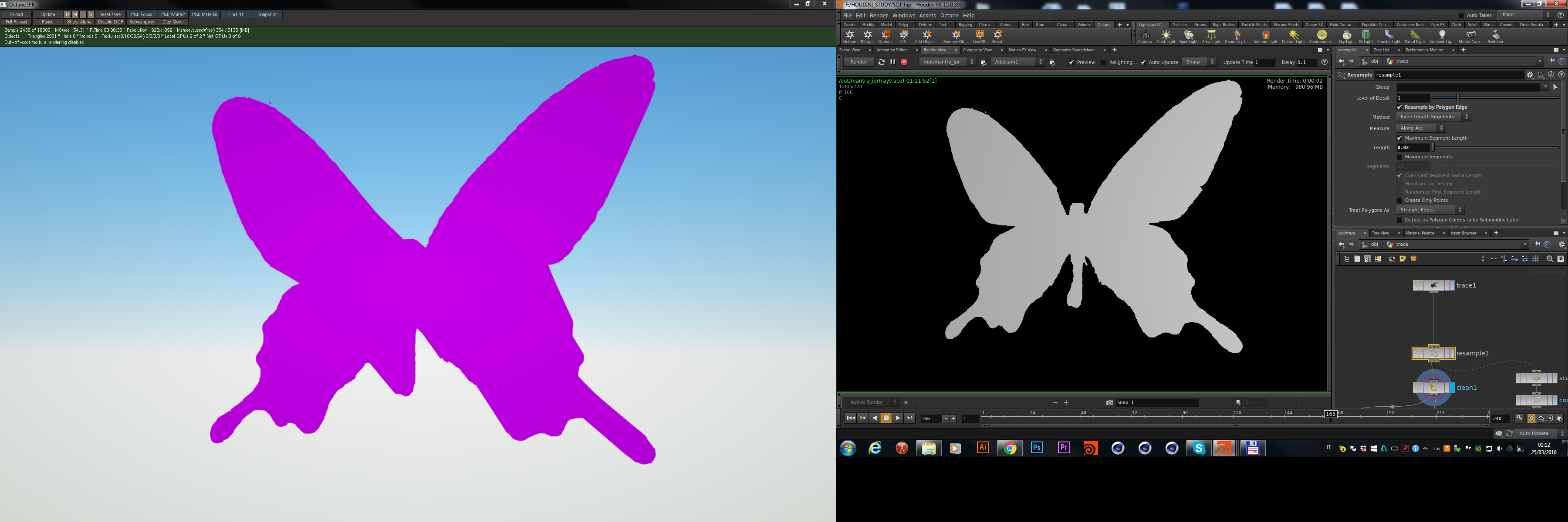

see my screenshot
with mantra working fine

It seems a problem with non convex NGons. Have you tried to add the Octane OBJ spare parameters to this object and enable the Tessellate NGons option? This feature is available in the last Octane 3 plugin alpha build.

not work for me

Sorry, I meant enable the "Tessellate NGons" option that is available in the last Octane 3.0 beta build, as you can see in the attached image.
viewtopic.php?f=102&t=52963
In earlier plugin versions you could use the Divide SOP node with the Convex Polygons option enabled.
https://docs.otoy.com/Houdini/?page_id=711
-Juanjo
