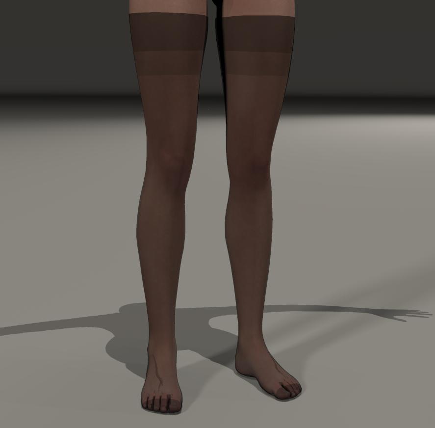

This is a basic render of the stockings in Poser firefly

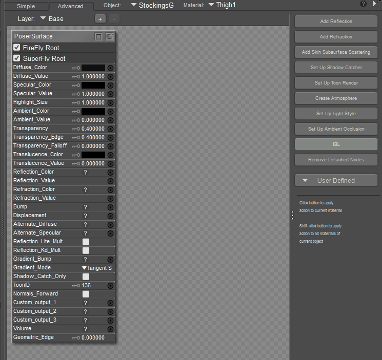

These are the settings for it. There were no transparency maps used.

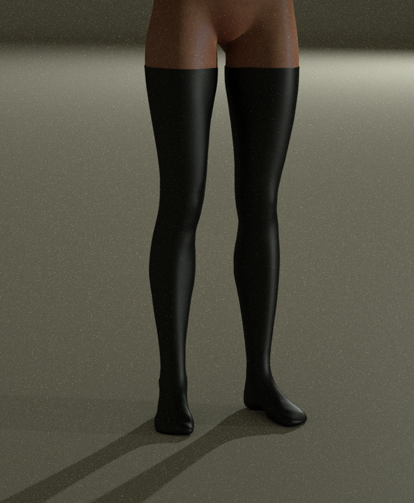

This is how it looks in octane with the basic octane file conversion

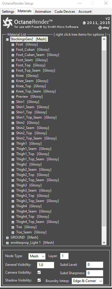

These shows how many different parts of the stockings need to be adjusted.

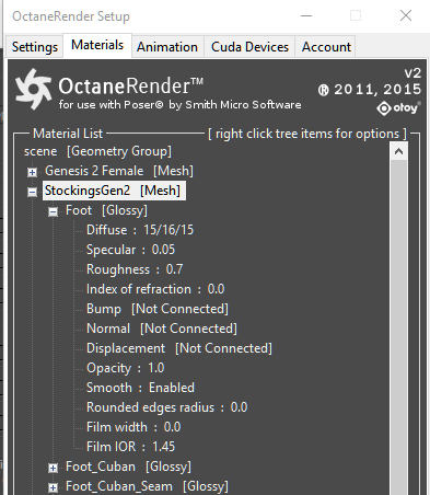

These are the settings that each of the those body parts is set to by default.

Based on the Poser material for "StockingsG" I do not understand how the Firefly is interpreting that to produce the 2 bands at the top of the stockings at "This is a basic render of the stockings in Poser firefly". How you got the right material? There would need to be at least a transparency map to produce those two bands at the top of the stocking. I wonder if there is other geometry involved?
Paul
face_off
Posts: 15830
Location: Adelaide, Australia
Edit to the above....the plugin does not seem to be picked up the transparency amount if there is no transmap, which I will fix in the next release.

In answer to your previous question he has achieved the banding simply by setting different transparency settings for each segment of the stocking.
Hence the multiple parts of the figure I need to manually adjust the transparency on.
