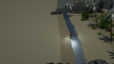

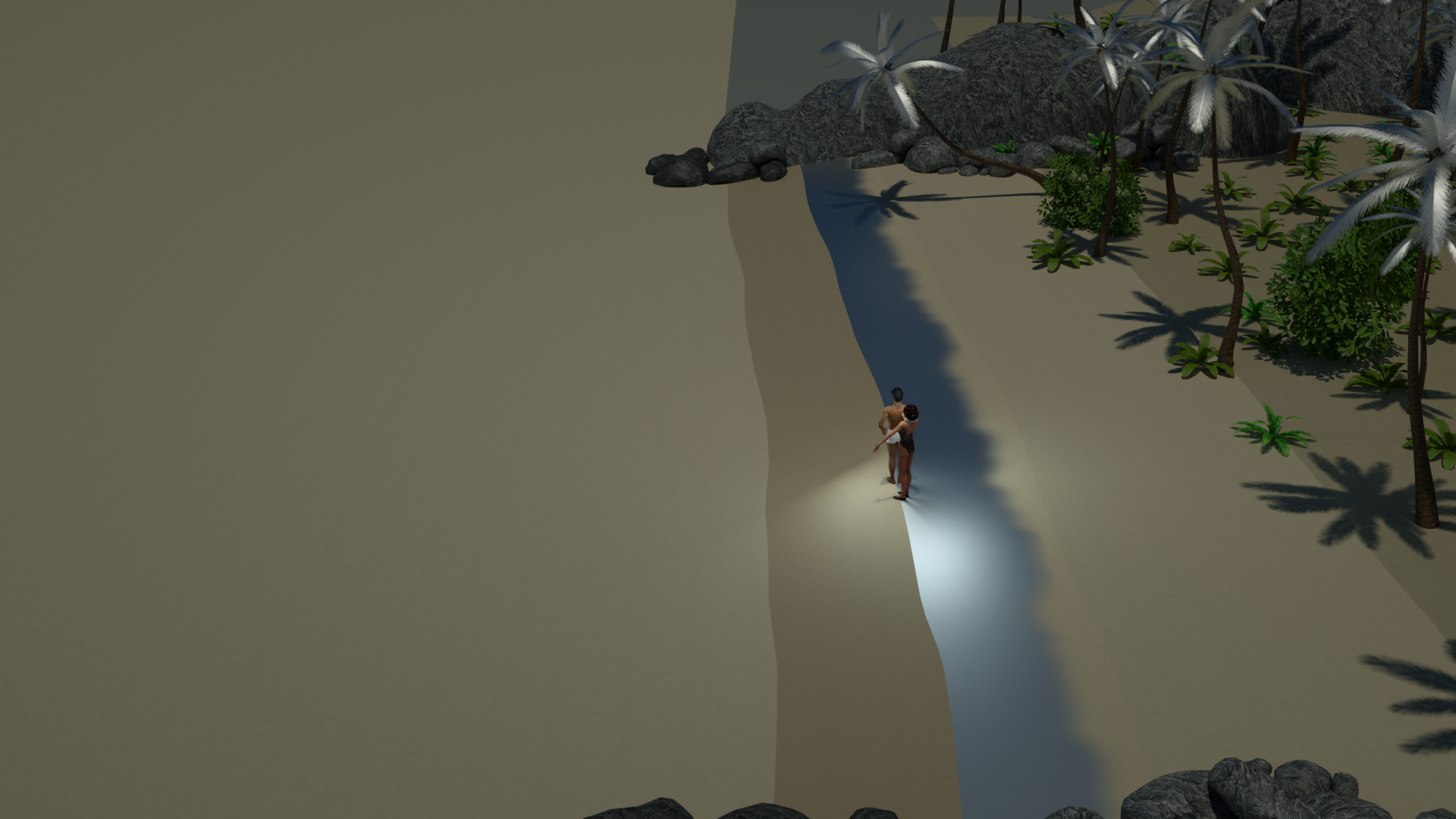

Im trying to render this shoreline
Moderator: face_off
ajr0717
Posts: 59
Joined: Wed Jan 21, 2015 7:44 pm

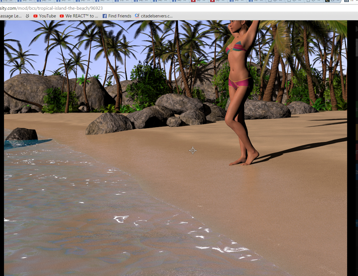

In the product the product makes the shoreline's water have a nice jagged and Realistic effect, the automatic conversion causes the shoreline to be a very straight flat line with shadows, I noticed the water in the Materials tab has this transparency map aplied to its transparency edge node, and I was wondering what I can do to correct this image more like the product's display image which was renderd in Firelfy

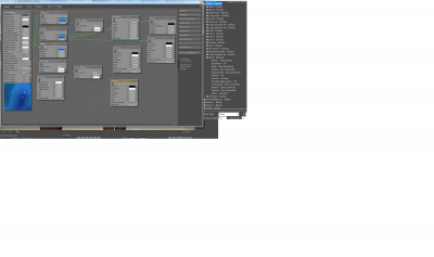

Can you post a screenshot of the Poser material for the water and the Octane material it converted to pls?

Thanks - it doesn't look like the transmap "2nd_W_TIB_Water edge.png" is used by that Poser material - so it's won't get converted to the Octane material.
