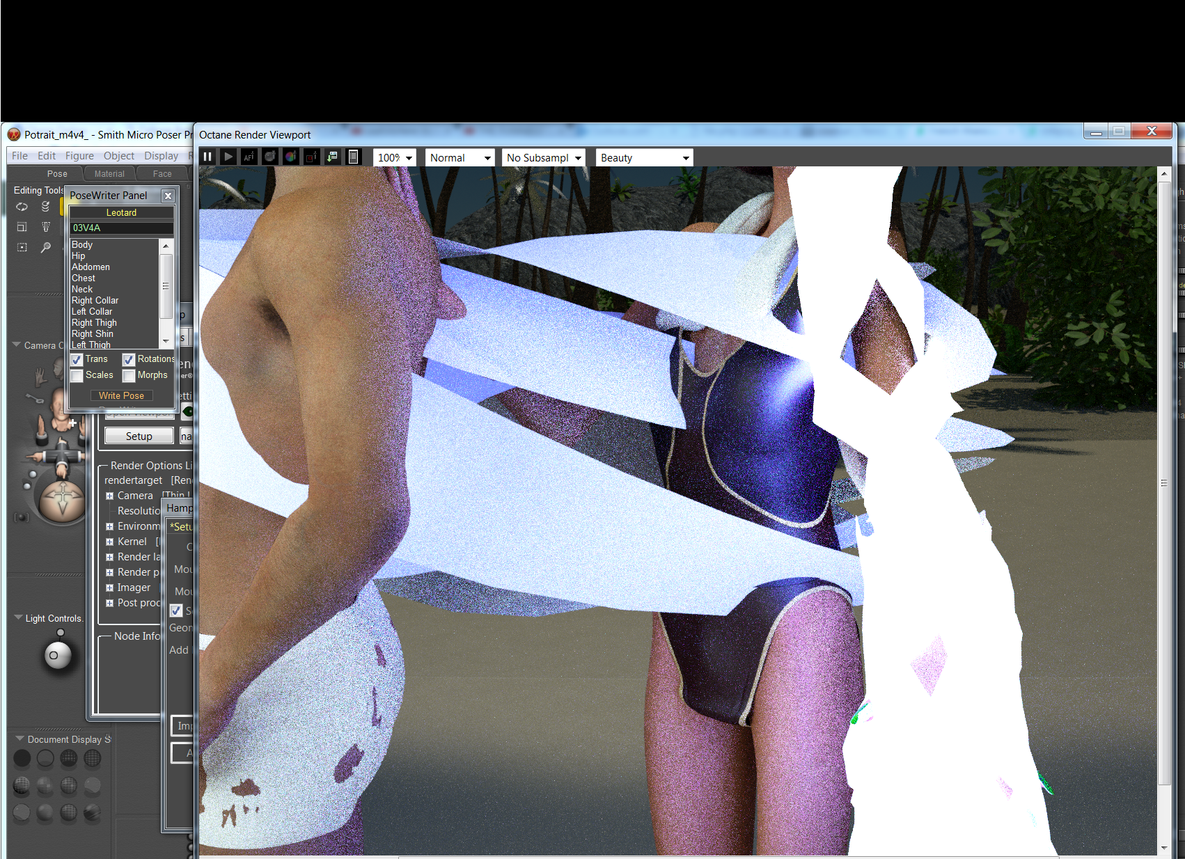

They dont convert properly. I am wondering about the technology of Octane Render and its ability to handle such transparency

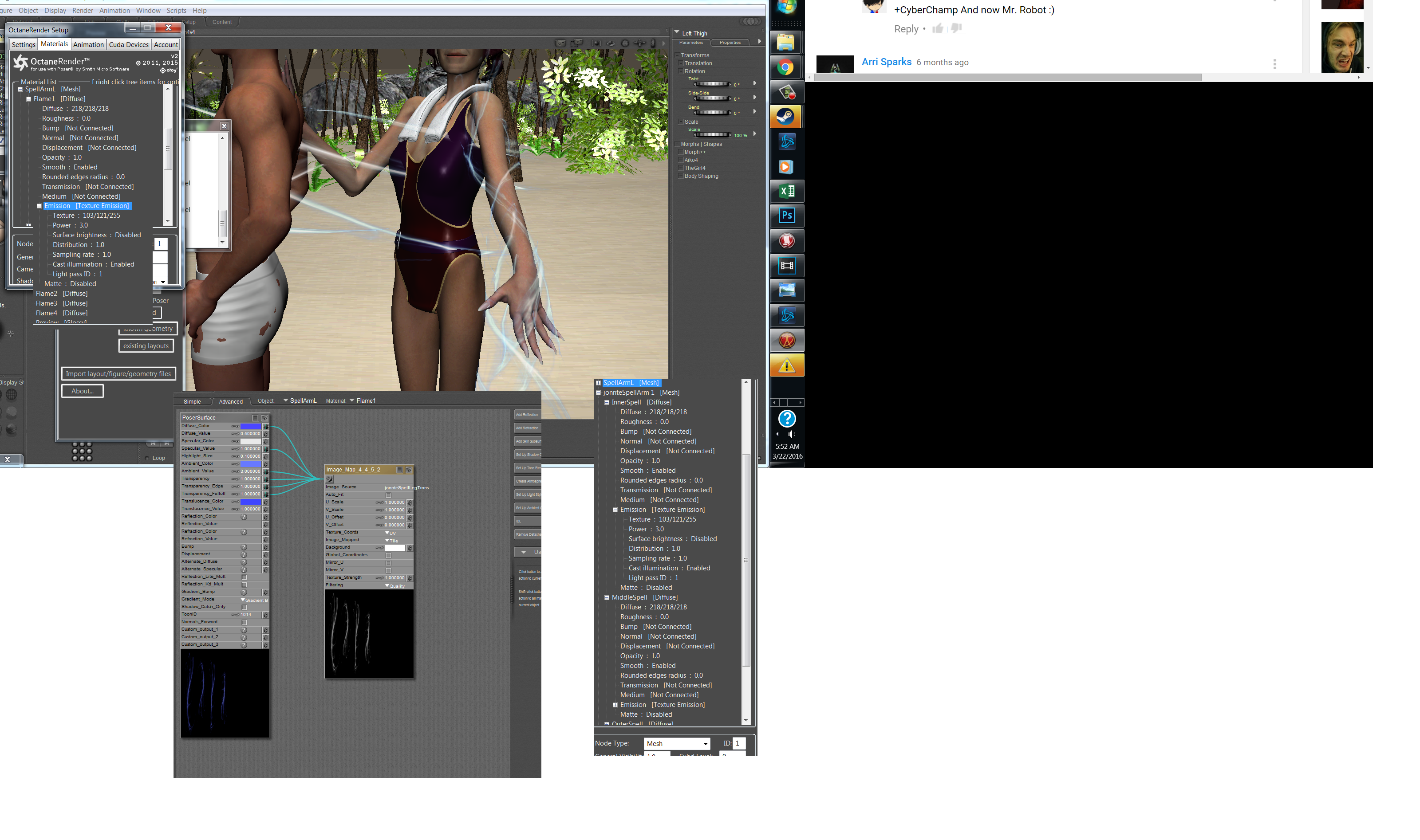

Can you post a screenshot of the Poser material of the "spell" and the Octane material that it converted to pls?

Here it is

Thanks. The plugin does not currently apply transmaps to emitter materials, however that should be possible to implement, so I will add it to the next release.

How can I manually do it? Where do I implement this transparency map in the Octane scheme
Set the Opacity pin to an Greyscale Image, and assign the transmap file to the Greyscale Image.
