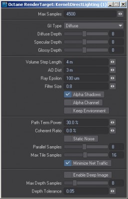

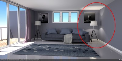

Trying, trying and trying and always noise in light !
Attached WIP if someone can help me.
I tried Pathtracing and PBR but it's with Directlighting i've low noise... but still too !

The directlighting kernel should work fine for this kind of scenes. Try to set the diffuse depth to only 2 or 3 bounces.
The light sources, and emission nodes, have a parameter "sampling rate" that you can use to add more samples to the small lights. Try to set the sampling rate of the lamp to 3 or 4.

Yea I think your looking great.....just up the sampling for those lights that your still seeing noise on. It's kind of a weird thing.....some lights wont get as even a look until you up the samples in that small area. And even though your in essence taking away processing from other areas they are already very clean and don't need further refinement.
I will sometimes bump up the samples to crazy levels...like 100, 1000, and 5000 sometimes depending on the scene and how many lights I'm working with.
As I understand it it's just a priority...so if you need more refinement in one area give that light the highest sample in the scene and just tweak from there. It's a bit of an art to optimize the scene with a lot of lights, but this scene should be no problem! Good luck and looking great!
