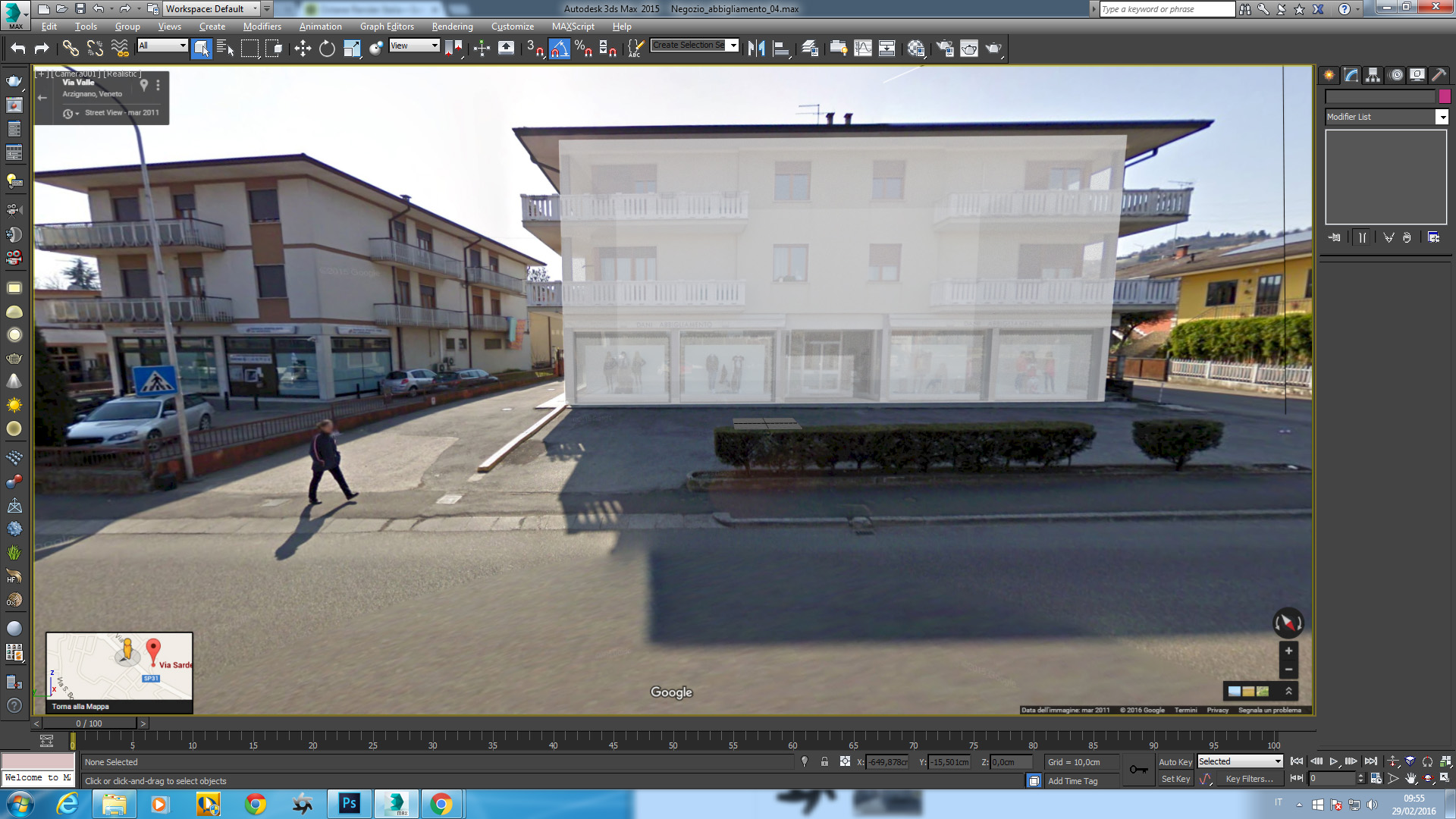

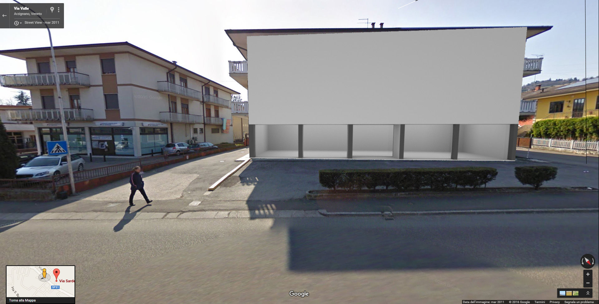

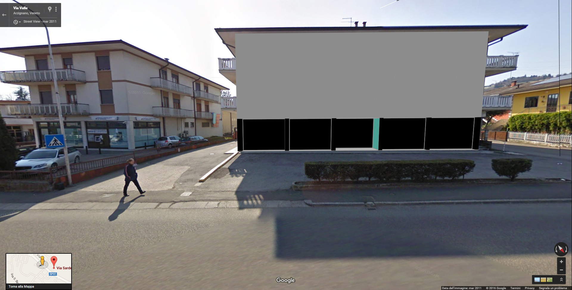

Another thing (not little at all) is the difference between what we see in the viewport and what is rendered (max viewport, scanline -perfect alignment-, octane render -bad alignment-)...not good at all, I often work with photo replacement/insertion and for making the things work, I have to use standard camera
