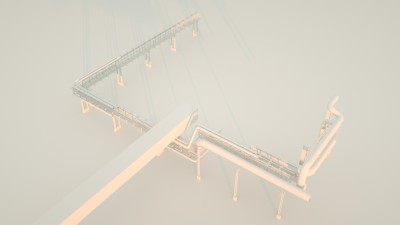

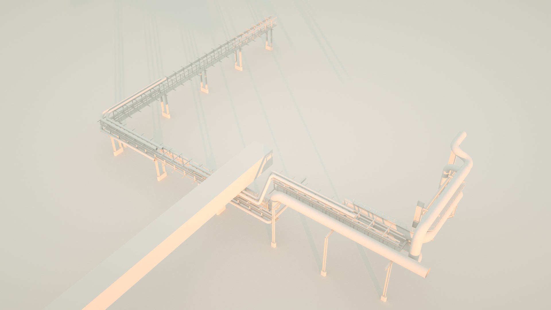

rendered from Cinema

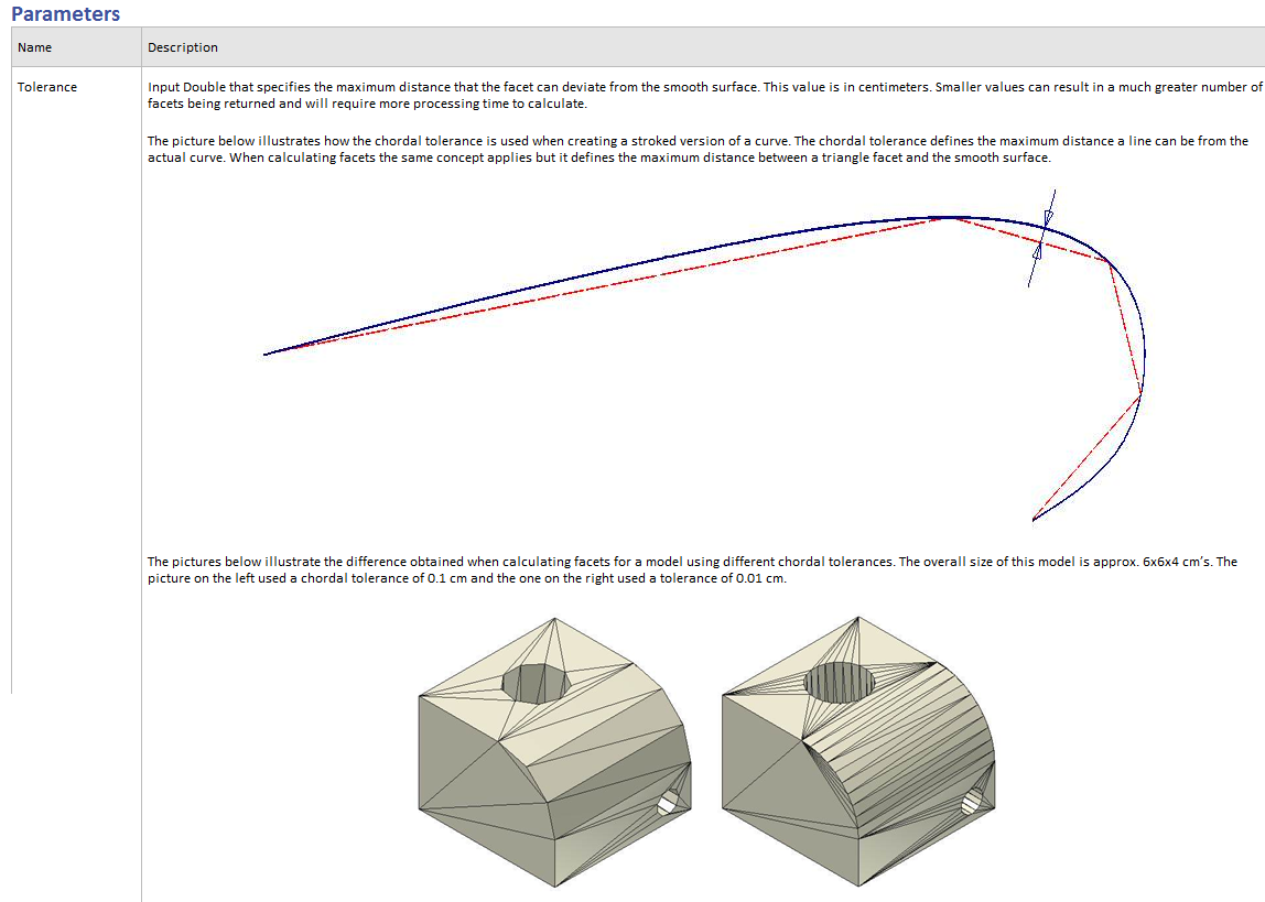

The "Tolerance" factor is best described from the API Inventor manual - pls see below.
From my experimentation - the valid tolerance range is 0.0001 to 1. Numbers higher than 1 are treated as 1.
The tooltop reads:
Specifies the Level of Detail to load into Octane. 0.0001 = high LOD and slower load times, 1 = low LOD and very fast load times. The Inventor LOD cap is 1 (so higher numbers than this are treated as 1).

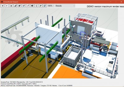

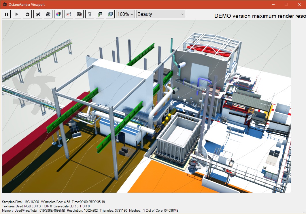

at the end it took 49:50min to export, ca. 15sec to voxelize it and renders fine. :)
Now I need someone in the company to give me money to spend. wasn't expecting this to work in the end. (50 minutes would be a lot less time I'll spend than exporting and importing in Cinema)
and it renders like a breeze - just 520mb of graphics memory used (tolerance setting of 0.25 gives me 3.73millions tris)
