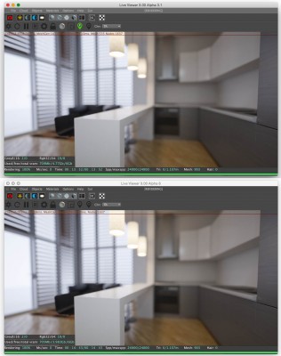

Here's some little difference between 3 alpha 1 and 3 alpha 6. It is a little bit slower than 3a1, but the image looks slightly different...
Just for understand, not a problem, how to set properly.

Export to standalone and let's compare in Standalone A3 vs A6. Check if you can the camera imager, environment,etc.. parameters.
You don't need to TFD. Just create a volume object. Select some VDB file and add any type of emissions. Or just use new volume medium in medium slot.
