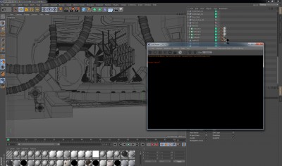

Hi guys.
I just move to C4 R17, and I can not render my scene anymore. I can use Octane for simple scenes but not for this one. It was working fine on C4 R16. Any ideas ?
Cheers !
Posts: 10581
Hi AlvaroLetelier,
please, firstly move to the latest version v2.5 R3, then be sure to disable the "All movable" option mode in Live Viewer/Options/Check Geometry and to choose the option "Manual Assignment" in Render Settings/Octane Renderer/Geometry Control. Then use an object tag to manually define the special or movable objects. It should solve your issue :roll:
ciao beppe
Posts: 16068
Location: Türkiye
I think that's not about it. Check console output for details. Do you know that you need enough free vram and also avoid the triangle count?
