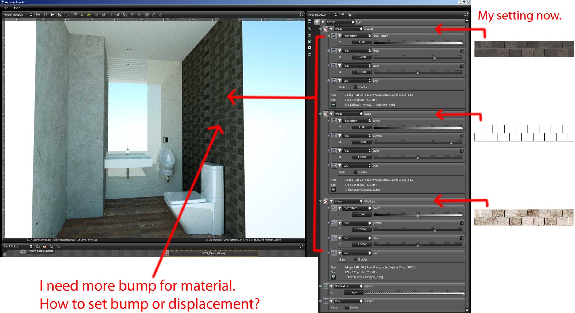

Here's my work. I try to set bump map for wall tile and floor. But it's not good. Can octane use displacment map or better bump? How setting for you? Need some comments.
Thanks.

Thank you. So can't use displacement in octane. Right?

Hey,
If the bump is'nt powerfull enough, you're probably importing you're scene too big.
try importing it a bit smaller with the OBJ mesh import settings panel in octane (at the bottom).
we're working on adding a power factor to it in the upcoming beta 2.3.
the interior render is very nice, but you should really supersample your renders to get smooth anti-aliasing using this technique:
http://www.refractivesoftware.com/forum ... f=21&t=878
Radiance
Radiance

Ok, i understand. I have read your technique. But i don't have time to try. Maybe after i buy new GPU.
Thank you all.
