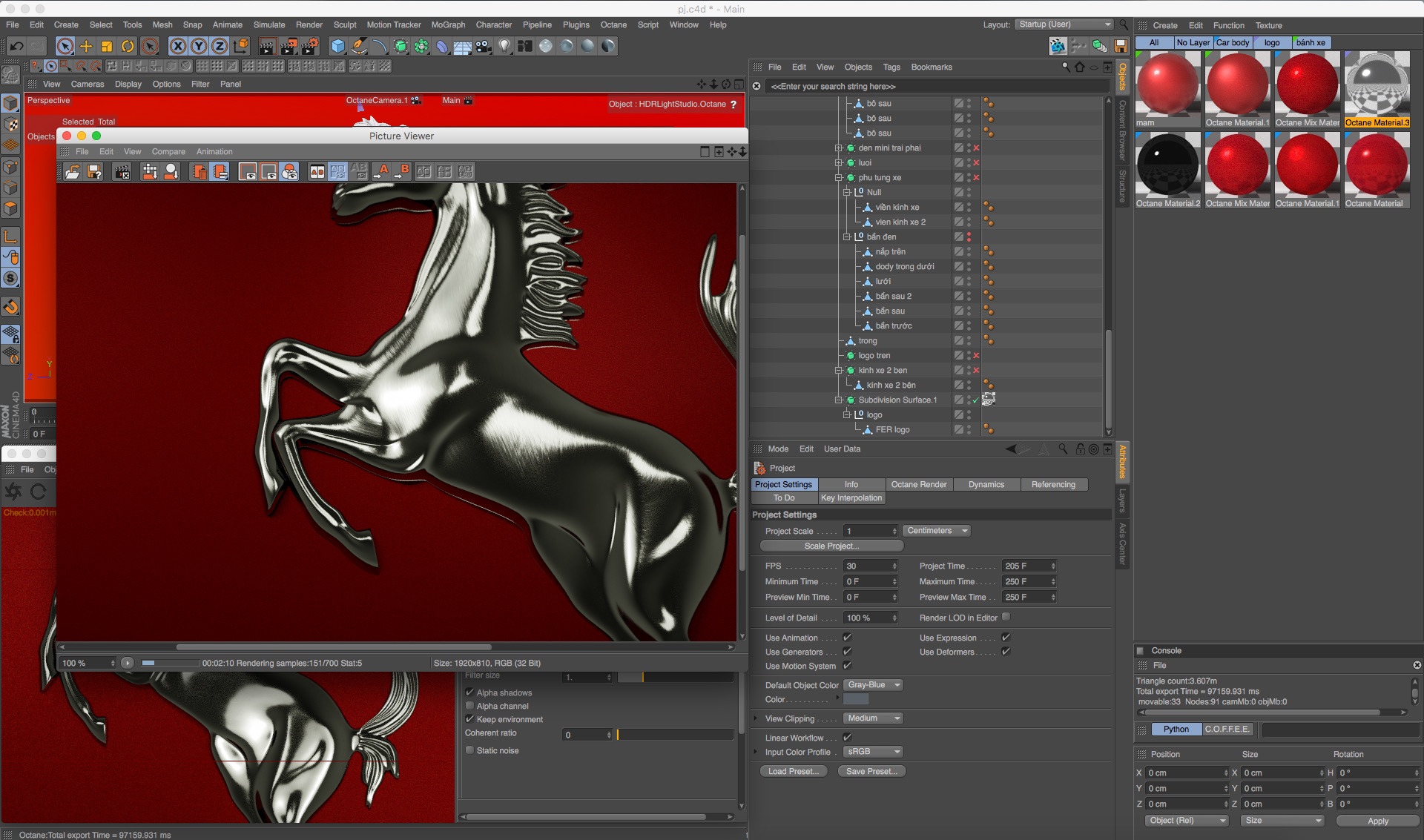

Hi huyrua811,
here it works at the first try :roll:
Are you using the latest version?
When you have this kind of issues, firstly try by adding an Octane object tag, in general, it should solve :roll:

haha tks you xD i add octane tab and its working xDDD tks you so so much . i love octane
