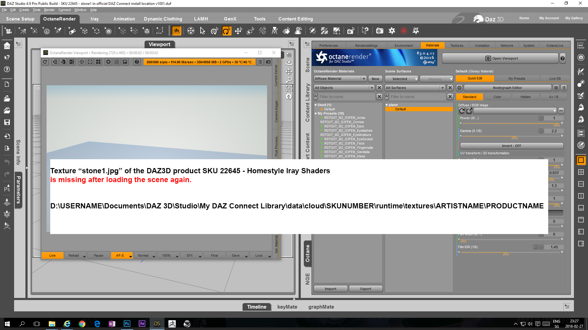

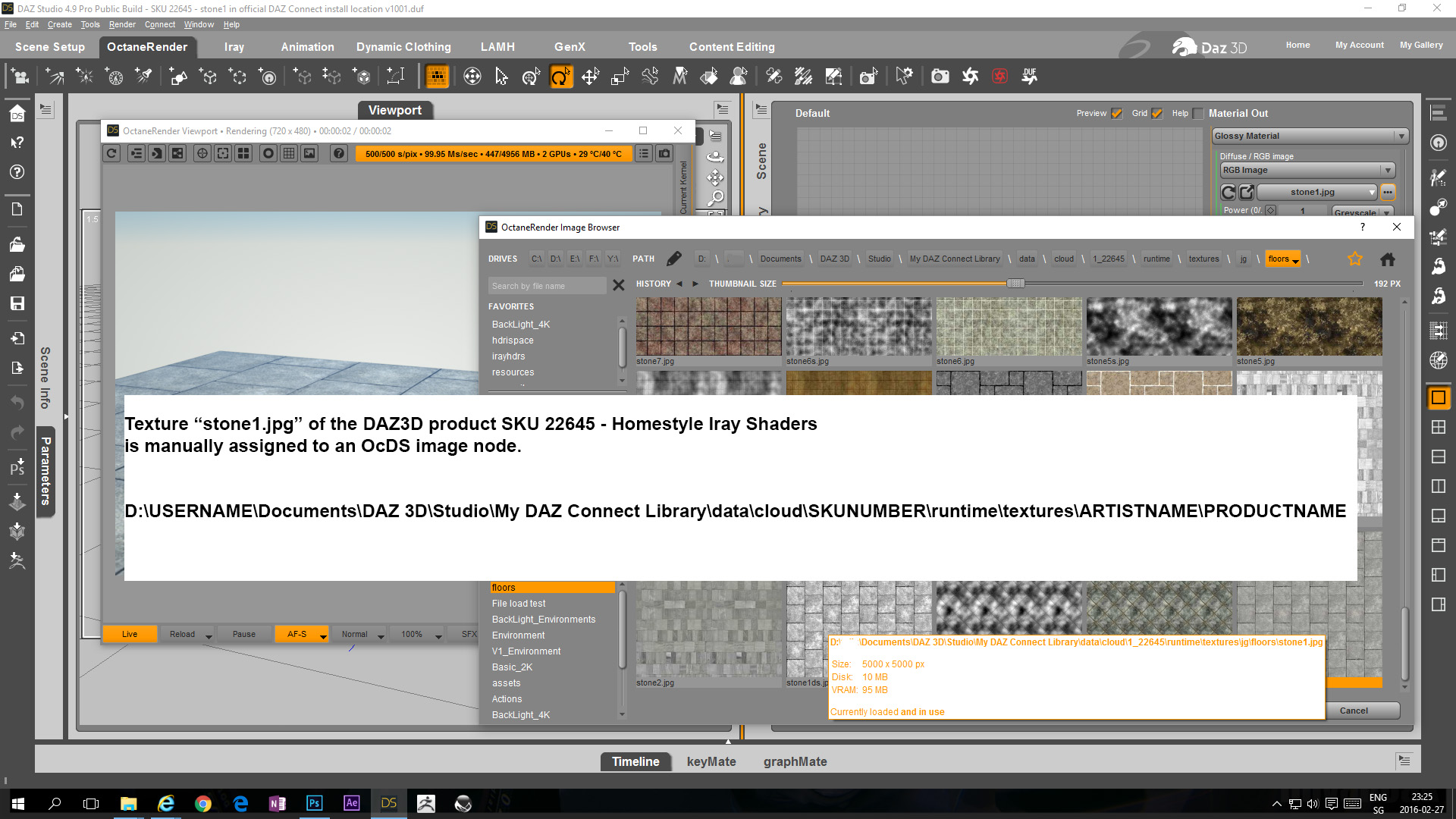

After the previous tests I started to suspect that any kind of images located in DAZ Studio library locations that are assigned to OcDS image nodes are missing when loading the scenes again.
Test 1 walnut texture from official DAZ Studio resources:
C:\Program Files\DAZ 3D\DAZStudio4 Public Build\shaders\iray\resources
Test 2 stone1 texture from product SKU 22645 Homestyle Iray Shaders in defined Library location
This can be reproduced with any kind of product that is located in the defined DAZ Studio libraries
D:\USERNAME\Documents\DAZ 3D\Studio\My DAZ Connect Library\data\cloud\SKUNUMBER\runtime\textures\ARTISTNAME\PRODUCTNAME

Screenshot of both errors:
