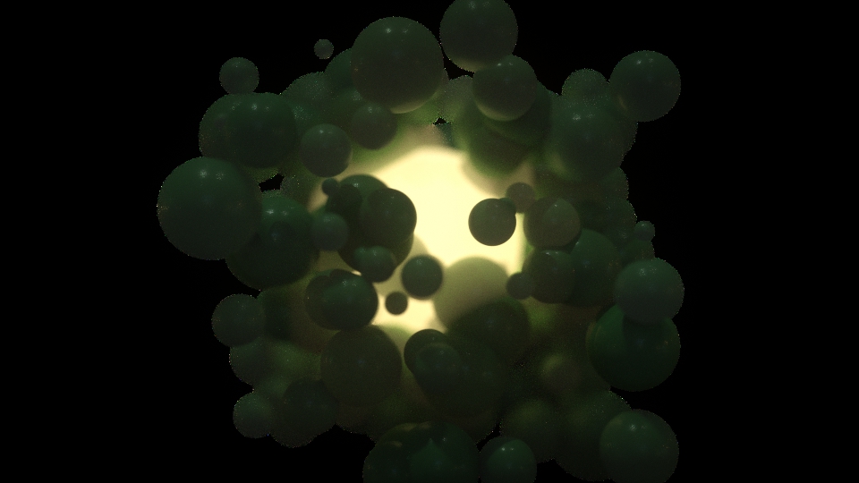

Okay, so I am getting to grips with Octane. Very cool renderer but lots to learn.
Underneath is a simple scattering test. My simple question is: how can I make the "outer" sphere have glossy reflections, but still show the same type of scattering behavious - sort of like polished jade spheres.
If I turn down the roughness the spheres become glossy but also show sharp refraction through them. If I turn up the roughness (as shown here) the solid mass scatters nicely, but the surface isn't glossy anymore.
Any ideas? Thanks!!!

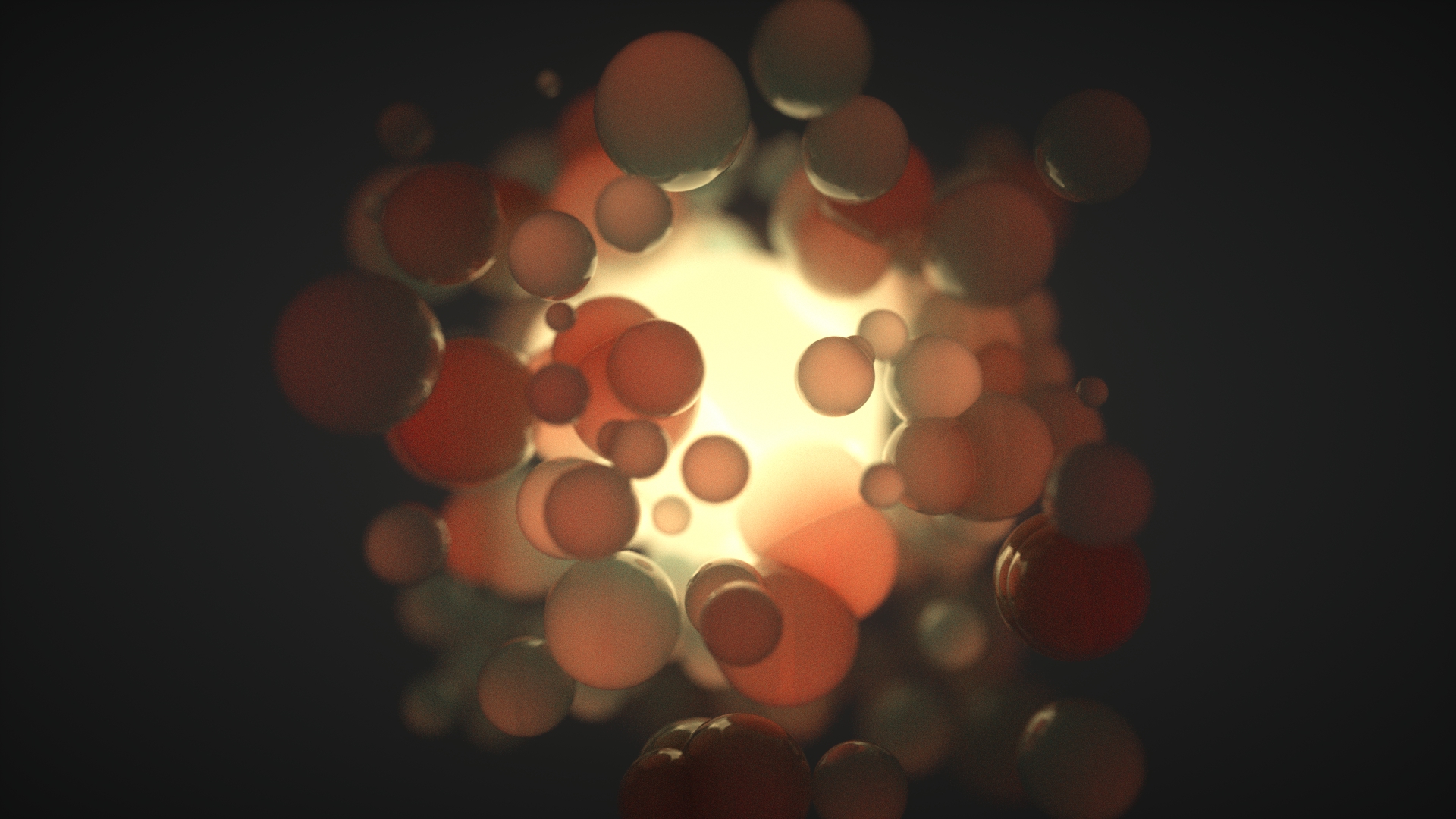

Step 2: I used the material mixer to mix in a material with glossy reflections. It works in a way, but unfortunately this has pretty severe limitations:
1) Let's say I mix the materials to 50% each. This means I can only reach a maximum reflection strength of 50%, so to speak (because if I mix it in at 50% I can never go above 50% of the strongest reflection level). If I want more reflection I need to mix in more of material B, but then I lose even more of my scattering behaviour in material A...
2) Mixing in material B means I also need to mix in the base diffuse color of material B, thus losing a part of the nice and rich color gradient in the scattering of material A.
Result here below. Is there anything that can be done to keep the nice and rich medium of my first render, and just add the gloss on top (without using compositing)?
Thanks!
