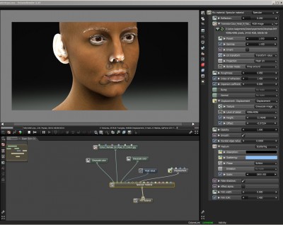

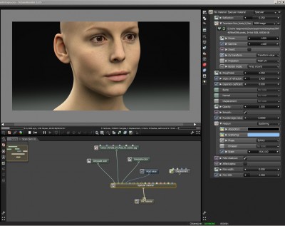

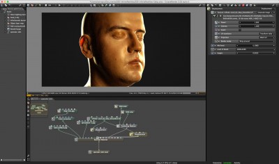

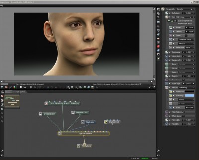

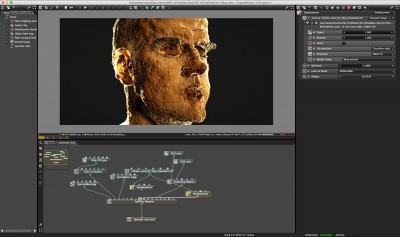

I'm having a problem using a specular material with displacement - looks like a bug to me.
The problem is in both Octane Standalone 2.25 and 3.0 alpha 4. As soon as a I add displacement to my specular material the scattering goes completely out of whack and looks very wrong. Adjusting the Scattering color and scale don't help, and neither did adjusting the displacement values. I'm using a 16 bit TIFF displacement map exported from zbrush. I also tried a couple of other image formats in the displacement texture input as a test but get similar major problems no matter what.
I tried looking around online for a fix with no luck. I saw an older post that mentioned a possible fix of plugging the skin material into both inputs of a mix material and using displacement on the mix material, but this didn't help or change anything.
Here are some screencaps showing the problem, showing what the material looks like in Octane 2.25 and 3.0 alpha before displacement and after displacement.
Anybody have any insight into this?

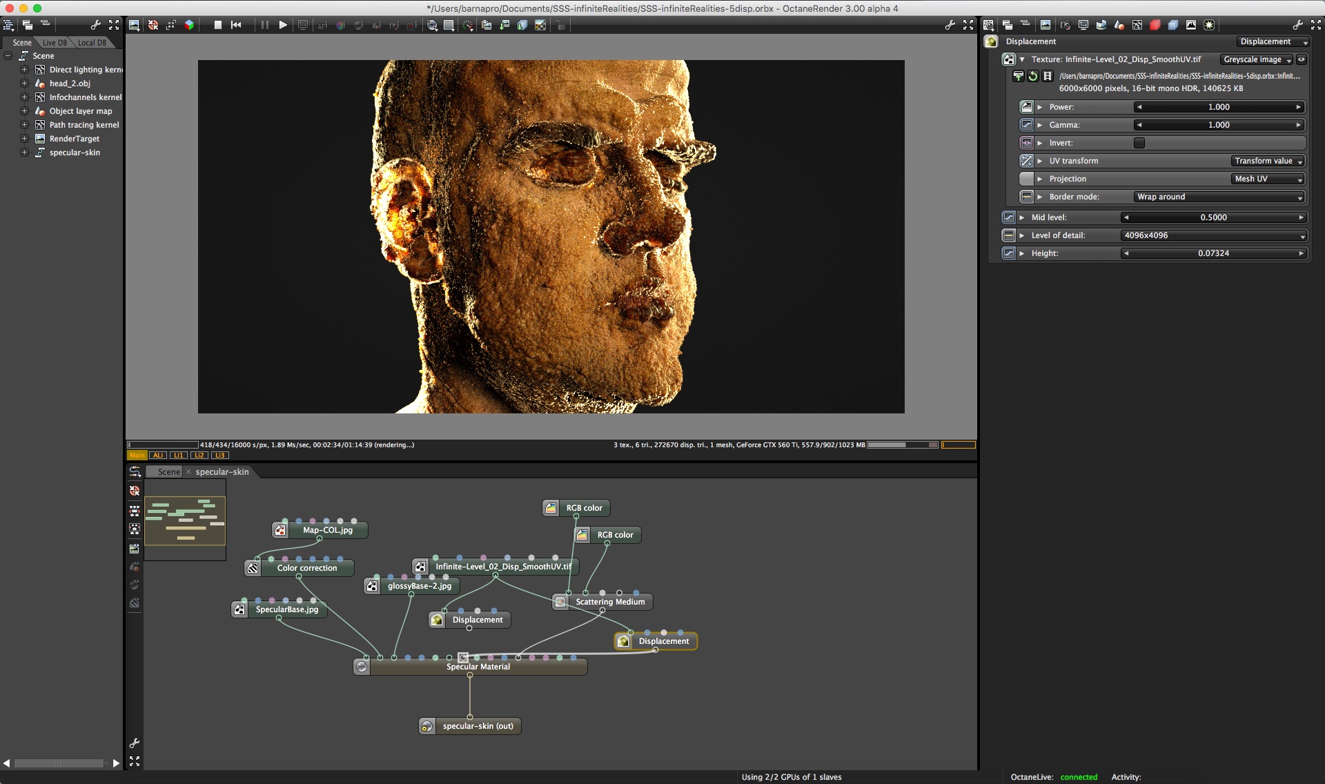

SSS skin shader in Octane 3.0 alpha 4 with Displacement

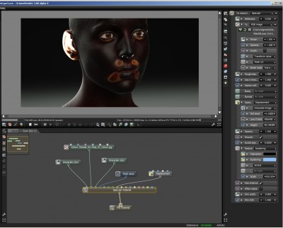

SSS skin shader in Octane 2.25 with Displacement

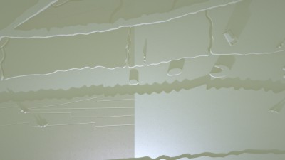

just create a new displacement node and replace the old one or change some parameters to restore the situation:
By the way, take care of the scale of geometry with Octane (all the measures are in meters), 14 cm of displacement are way too high for a face :)
here is how looks like at a half of your value:
crazy effect :D

Thanks! I adjusted the scale of the model and got better results, but still with artifacts. Looking at the render you posted where the displacement settings are correct, I think you might actually be experiencing the same problem that I'm having.
This is only happening on Specular materials - Even with the model at the proper scale and the displacement height set extremely low, adding a displacement map to the node noticeably darkens the color of the whole object and creates odd artifacts at the edges of geometry. I can see these artifacts even in your render with fixed settings - in your render there are thin glowing lines around the extreme edges of all geometry. If you remove the displacement node from that scene, do those weird glowing lines go away? If so, then I think you're experiencing the same problem that I am.
My memory of dealing with a similar issue in Octane about a year ago is coming back, and sadly I never found a solution then... if you can double check your own scene and see if those glowing lines disappear when you remove the displacement node, that would make me think it probably is a bug caused by displacement. Should I file a bug report with Octane if that is the case?

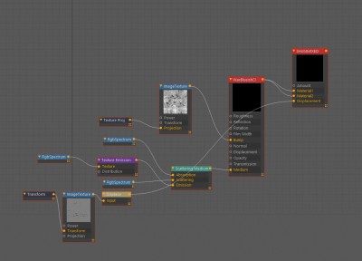

I'm having the exact same problem. Has this issue been addressed yet?
The material turns way darker, not the same as inverted normals, but as if the density has changed.
I also tried the older method with mixing the same material twice and using the displacement channel from the mix material, but to no avail yet...
Any fixes?

Hi Beppe, thanks for replying.
See attached the nodes and the differences.
I'm using V3.08 by the way.
Left the displaced SSS, right without.
