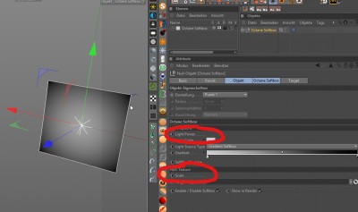

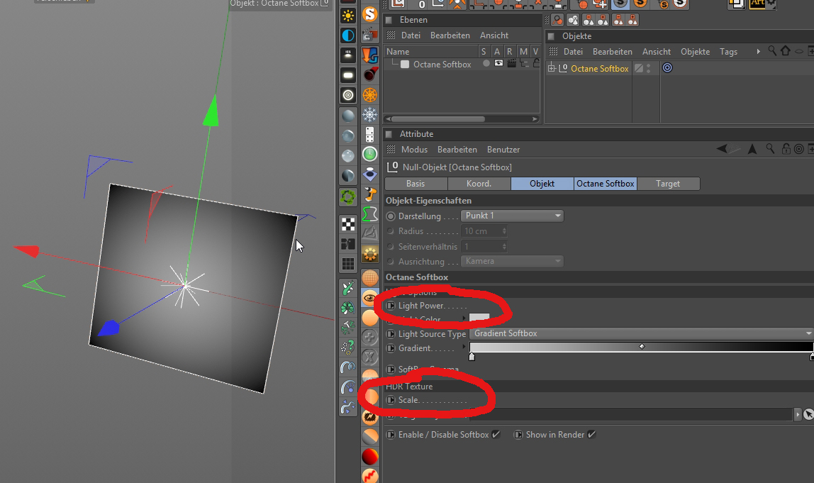

Haveing some trouble with sliders in Octane-related rigs. I am using Octane Studio Tools v1.0 and suddenly I experience that some sliders are gone.
Same thing with Octane Studio Kit 1.1.
I tried changing the slider types in Octane settings but it didn't help.
Does any one know why?
Ron

Talking about sliders, has anyone experienced some of the sliders are from 0-1000 when previously (2.24) they were 0-1?
Dell Precision T5600 | 2 x Xeon E5-2630 | 2 x GTX980ti
Posts: 16068
Location: Türkiye

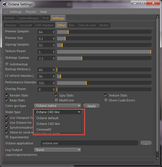

JPCastel wrote:Talking about sliders, has anyone experienced some of the sliders are from 0-1000 when previously (2.24) they were 0-1?
Don't know what you mean but keep slider type=Octane type from settings. C4D type is buggy.

JPCastel wrote:Thanks Ahmet.
I'll keep a lookout for what I mean, I can't find any now. I must be losing my mind.
Thanks for R3
This one. It may help, don't know what's the problem.
