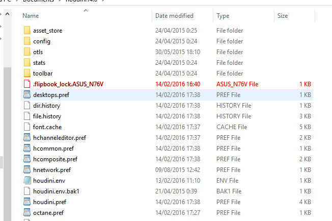

It happens for me also, yesterday was all ok when Octane invoke Mplay, today the console just says that "error opening the tile device", so Mplay doesnt work anymore.

This problem can be something related to some lock files that MPlay store in the Houdini configuration folder.
Please check your Houdini configuration folder ($HOME/houdini15). If at some point in the past your MPlay application have crashed, sometimes it could leave in this folder a file named something like ".flipbook_lock.computer_name". Remove it and the MPlay should work again without problems.

Works Perfect!! Thank you!!
