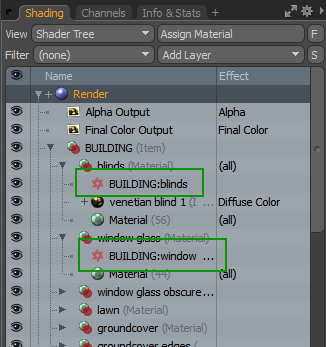

Only thing I'm confused about is you mentioned my material groups had ":" in the names but I don't see that on my end. I mean not in the group name themselves but yes in the Octane Override name. I didn't add the ":" they were auto generated upon creating the octane override. So should I remove them every time I create an octane override? Furthermore, I'm running Octane Modo plugin version 2.25.0.95.910 which is a later version than the one you mentioned, yet I don't see any warning for illegal characters in shader tree group names.

Hi Dino - you are right, my mistake. The ':'s should not be in the material group name in the Shader Tree, and your scene doesn't have the ':'s in those group names. I got confused with the Octane Override name having the ':' in it - but this is the correct behavior since it shows the Shader Tree hierarchy the Octane Override is for.

All good.. for fun I tried adding ":" in the material name (not the override) and I was given the warning, so no probs.
