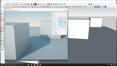

Hello Captain, there is another bug that has been with us for as long as the proxy issue.
I am talking about the camera depth of field feature , that used to work great 5 months ago and in the latest versions of the plugin is not working at all
i tried increasing the aperature size to ridiculous values but nothing gets blured out in the image ,so you can't use the pik focus feature .
Maybe you could have a look on this matter too , for the next release.
thanks , hope you can do something about this.

Have you tried increasing the "Aperture Edge" above zero? I haven't used the focal depth much, so I am unsure what result is expected, but in order to get any response I have to increase the aperture edge to .1 or above. Then you can play with the "Aperture" number. Strangely, with the aperture set high you can pick about the scene and it only rarely focuses on what you are clicking on which seems suspicious.
