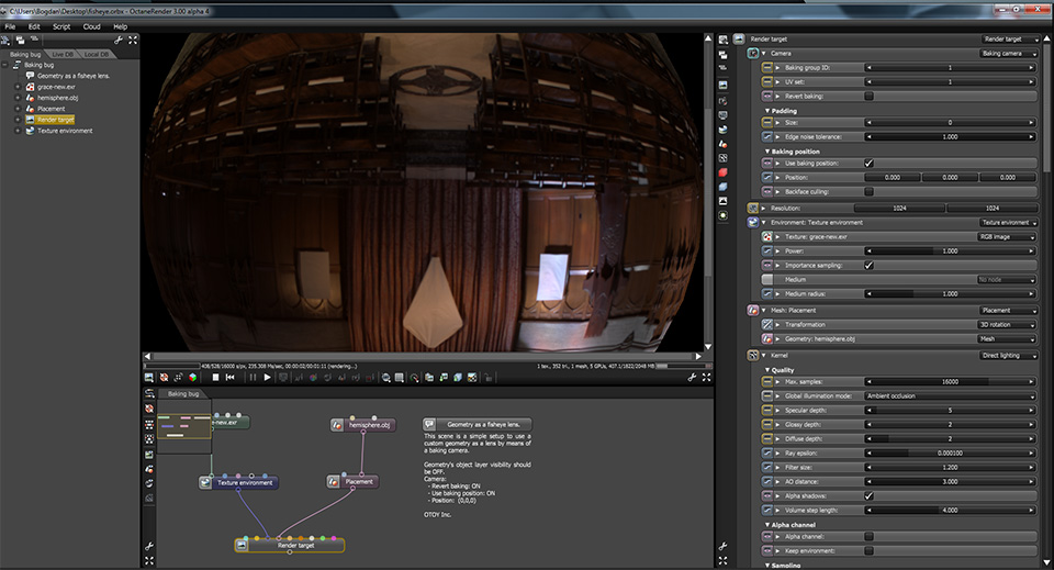

I've tried to use the "Revert baking" feature and found out that the geometries used for baking don't have normal smoothing applied or exported.
I've tested the example posted by mojave in the "Re: What is "Revert Baking" used for?" thread and everything is fine, but if I try to replicate this in Cinema, I'm getting faceted results.
