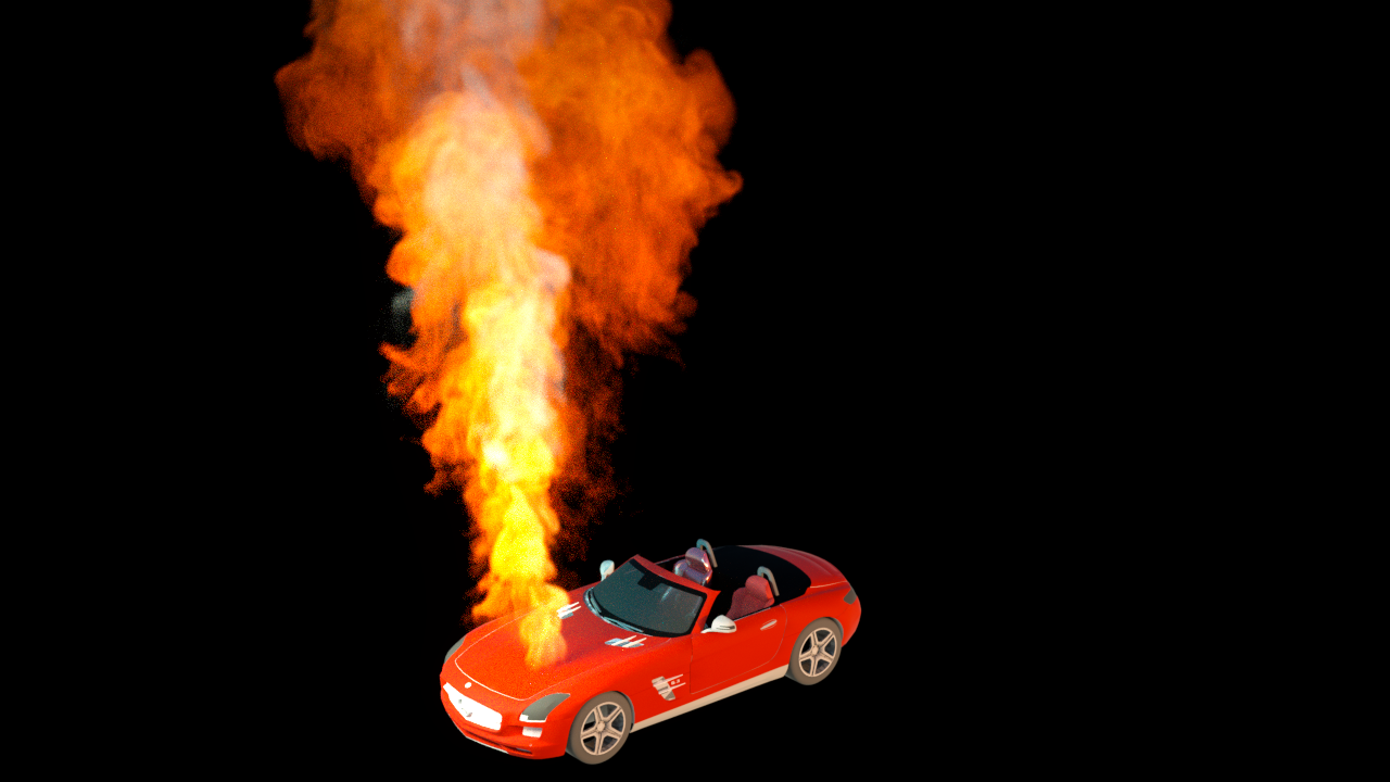

Notiusweb
Posts: 1285
Yeah! Take that, UV-mapless red car...
A unitless temp VDB where Black-body emitter did nothing, used a mesh sphere to fake a glow on the car
