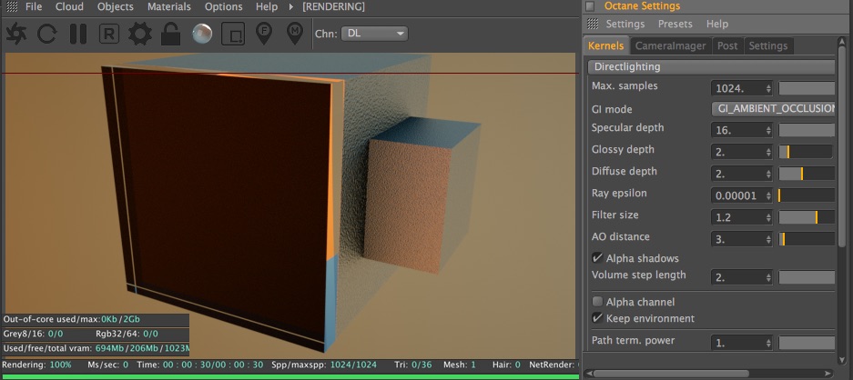

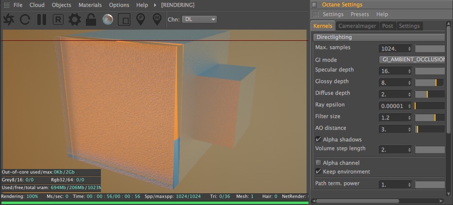

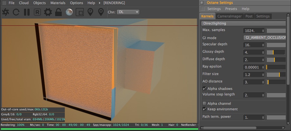

I forgot to mention that also the glossy depth has a great impact, here is the same example with different glossy depth:
DL-AO-16-2
DL-AO-16-2
DL-AO-16-4
DL-AO-16-4
DL-AO-16-8
DL-AO-16-8

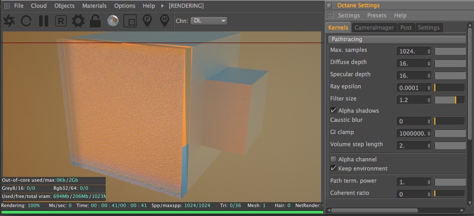

but with this settings, the render become slower than Path Tracing, even with greater depth:
PT-16-16
PT-16-16
my suggestion is to always use the Path Tracing kernel for products shots, with GI Clamp, Path termination power and coherent ratio is become more faster and efficient than Direct Light diffuse, and in some circumstances, even faster than AO. Just my two cents ;)
