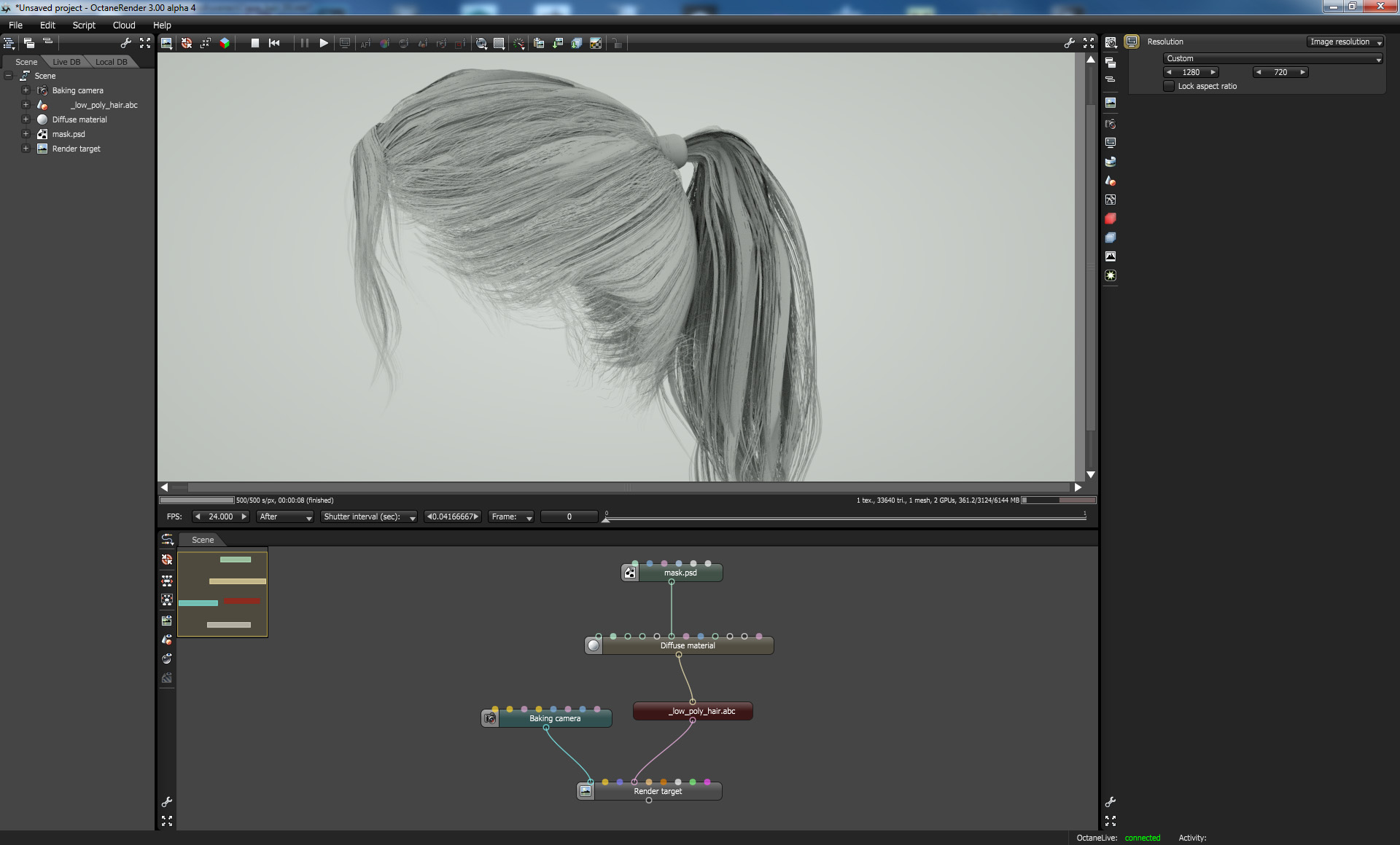

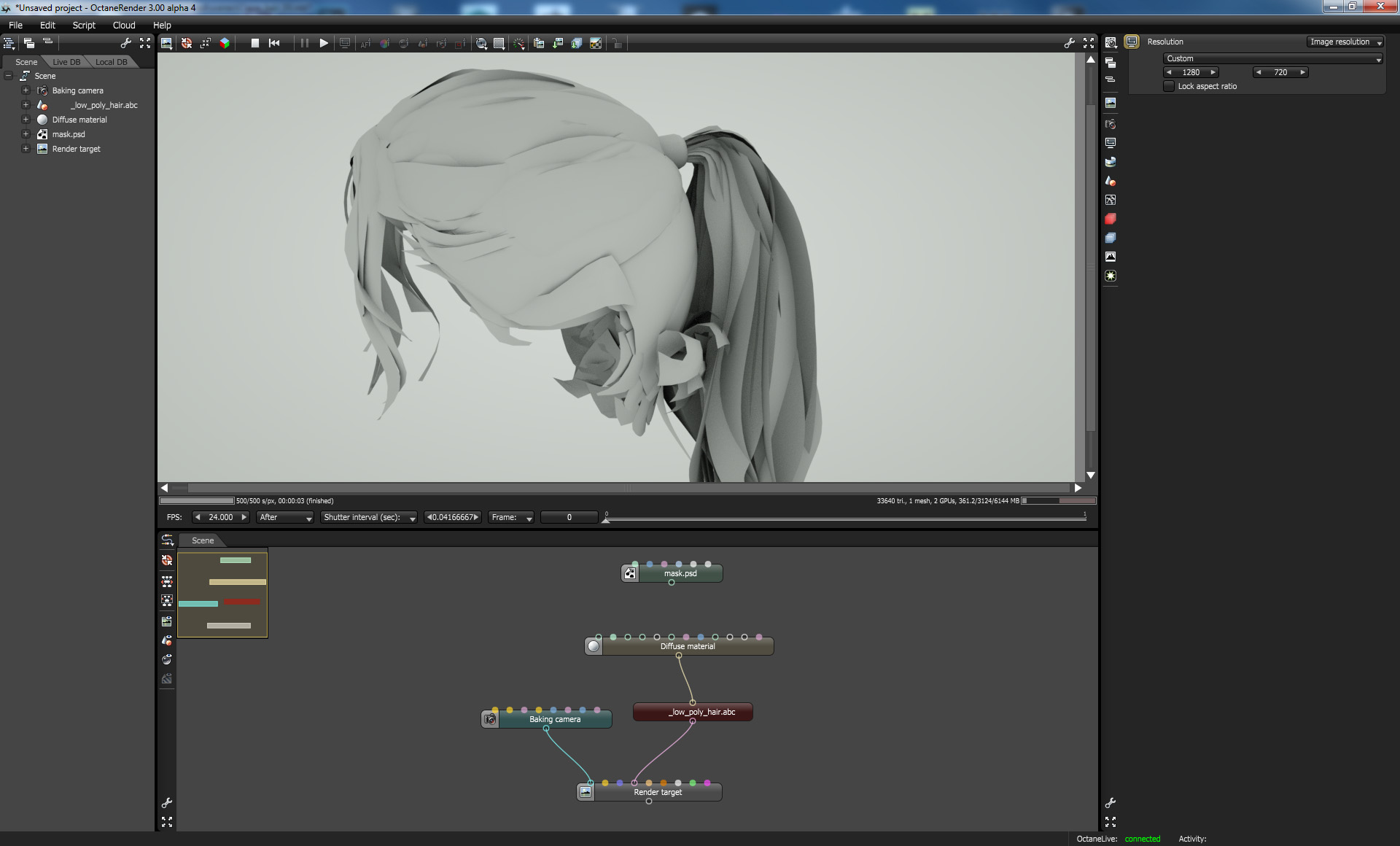

This is my model. It's hair made out of flat stripes, for a real-time character.
And this is how it looks with my Opacity Mask applied:

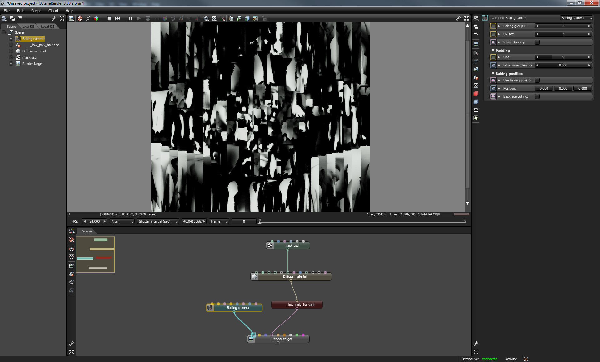

I want to bake the Ambient Occlusion to use in my game engine, my Opacity mask is on UV channel 1, and I want to bake my AO on UV channel 2.
Unfortunately, since Octane Baking Camera ignores the Opacity mask, the baked result is this:

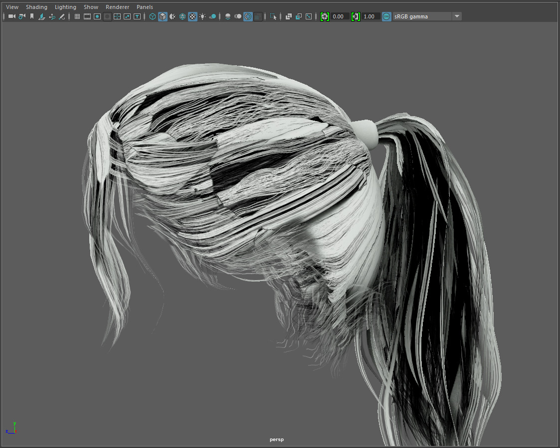

And obviously that doesn't work at all since it's calculating the AO of the entire polygon, which has a much bigger occlusion area than the same polygon+opacity mask, so the result, when applied in Maya is this horrible mess: :x

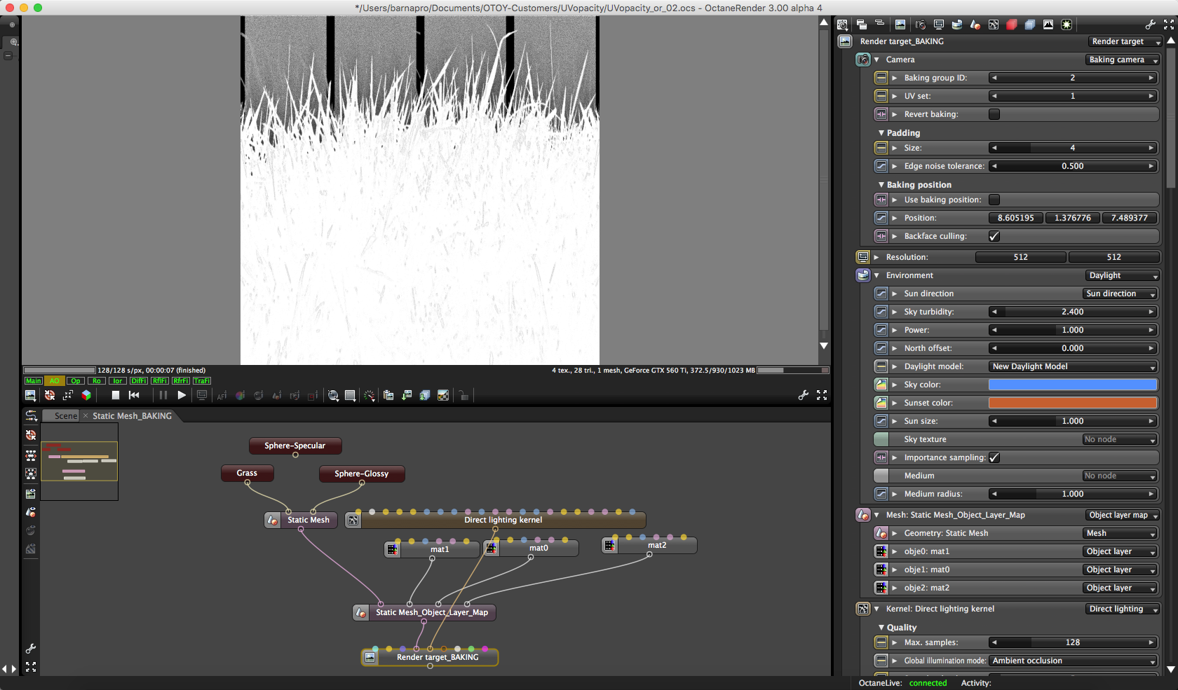

since I cannot use more then one UV set in C4D it's a bit hard to do an exact test like your :roll:
anyway it seems to work correctly if the opacity map is in the same UV set :roll:
here is my simple test scene:
UVopacity_orbx_02.orbx.zip
(1.77 MiB) Downloaded 235 times
I think the best is if you could create a simple scene that shows the issue and share it via PM with mojave ;)

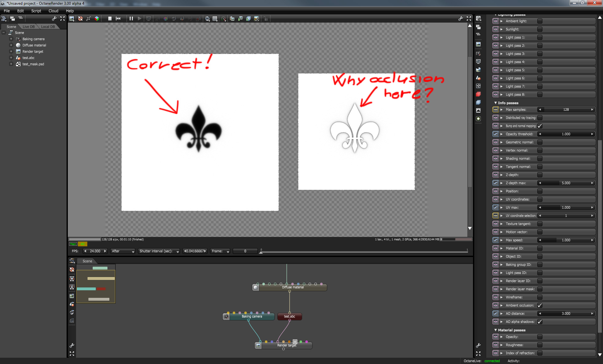

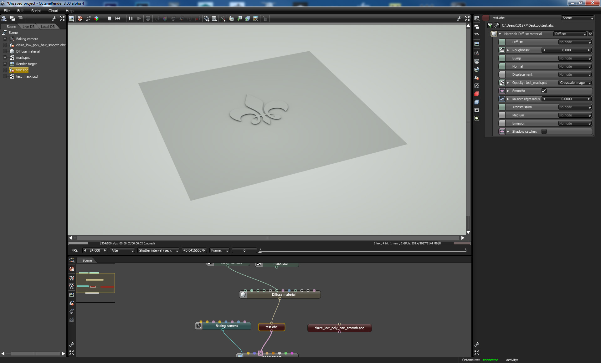

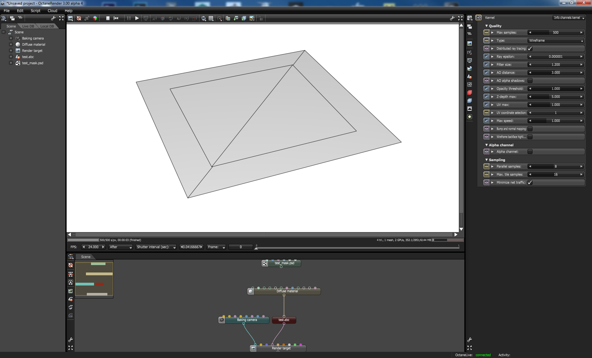

Ok, to help you debug it I made a test scene:
This simple scene has two planes, a larger one with a smaller one on top, both have two sets of UVs.
The plane on top has an Opacity mask with a shape on it
But when I bake it, you can see that the plane underneath doesn't receive the AO from the shape, but the AO from the whole plane above.
I've attached the scene so you can debug it. ;)

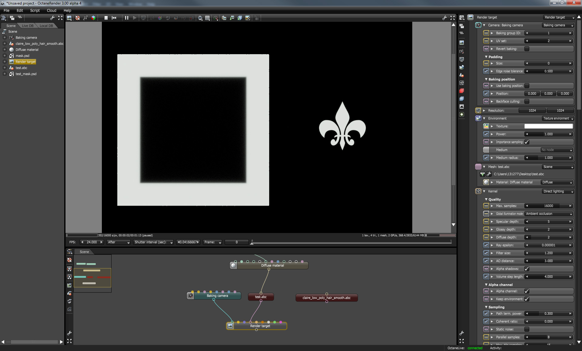

More testing:

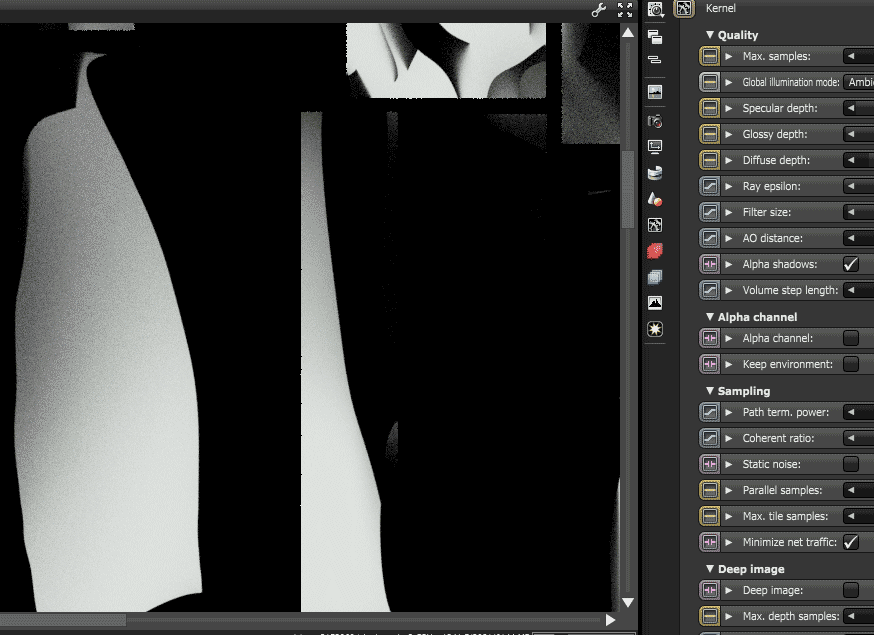

Using the AO render pass seems to work! Well, kind of. As you can see from the image below, now the correct occlusion gets casted on the plane below, but why do I see an occlusion border around the shape? The polygon on top should be completely white.

Rikk The Gaijin wrote:Ok, to help you debug it I made a test scene:
What works and is much faster to render anyway is using the info channel kernel with channel "AO" and enabling the option "AO alpha shadows" instead of the direct lighting kernel. We will look into why it's not working with the baking camera.

abstrax
Posts: 5510
Rikk The Gaijin wrote:Yep, I wrote it just above your reply. :lol:
Yes, indeed. Arturo probably has already a fix for the issue of the weird "self-shadowing" you can see in the info channel case. The original problem with direct lighting (or any other kernel, except the info channel kernel) seems to be a bit more tricky.
Thanks for the feedback anyway.
