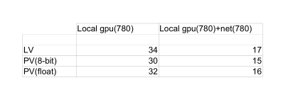

Here is my test results. I take the times from beginning of first sample to maxsample. It's very simple scene on PT, maxsamples=1000, fullHD
speedtest.zip
(238.71 KiB) Downloaded 200 times
