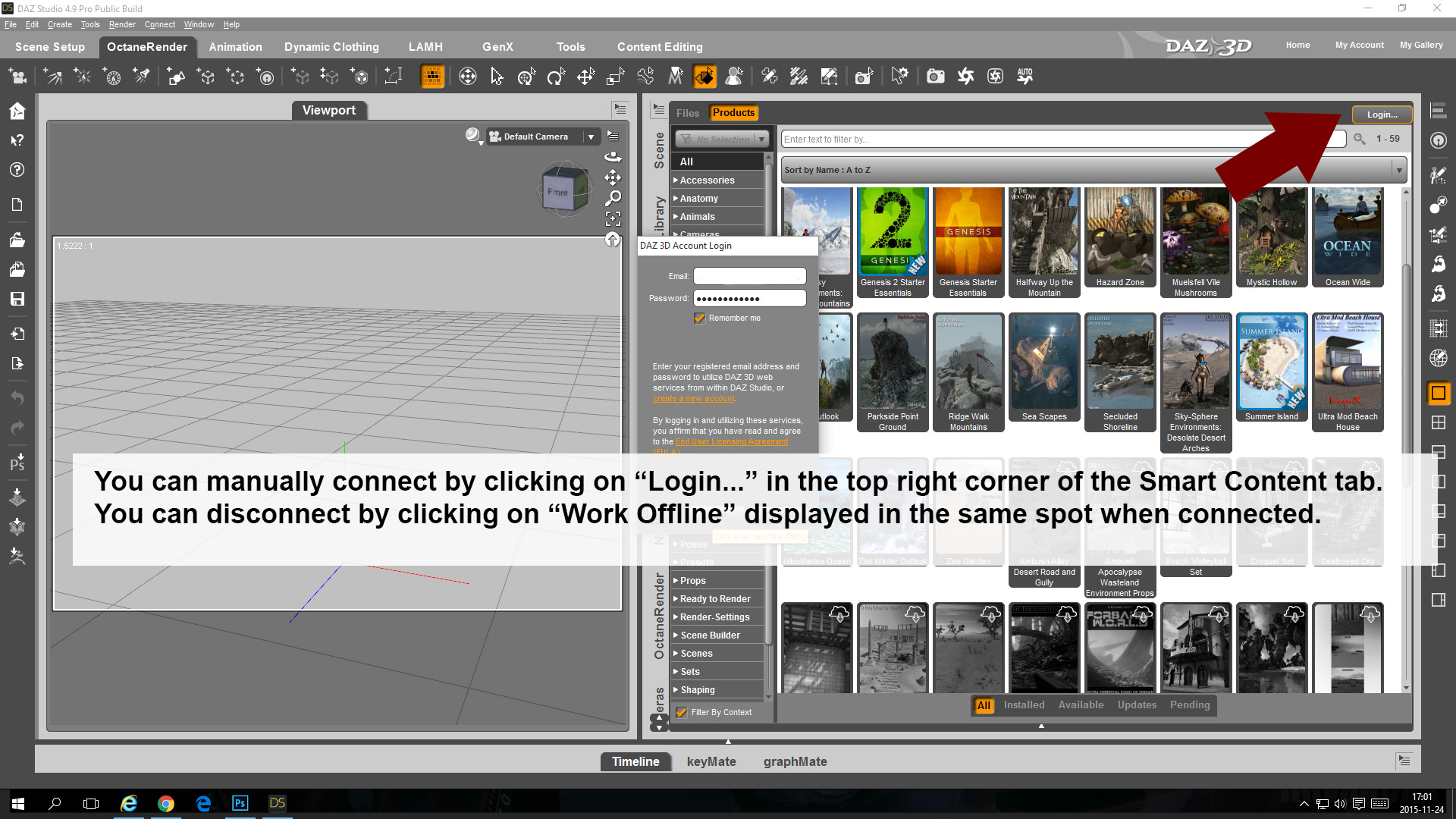

Login or work offline
You can change between an online or offline modes with the click of a button.
