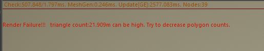

I thought, that the triangle-limit is gone in V3.
regards
Mike

Posts: 16068
Location: Türkiye
miohn wrote:Hi,
regards
Mike
Gone i suppose. But i haven't updated plugin for this warning. But there is a Render Failure anyway.
