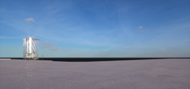

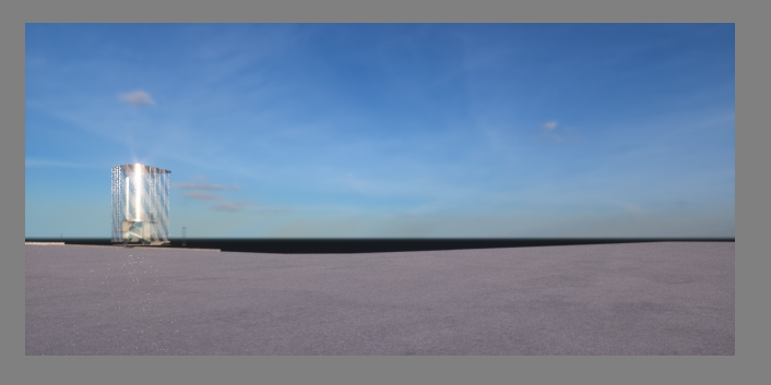

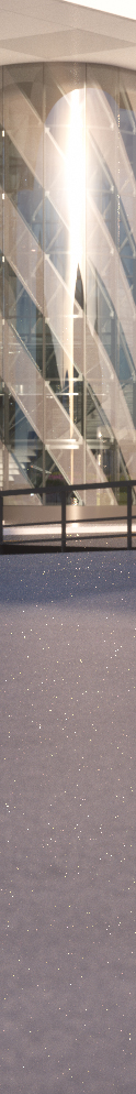

Octane 2:
Octane 3:
In Octane 3 hot pixels are very pronounced. Both stopped at 1000 samples. In Octane 2 hot pixels disappear if I let it cook more but in Octane 3 they are still there.

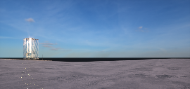

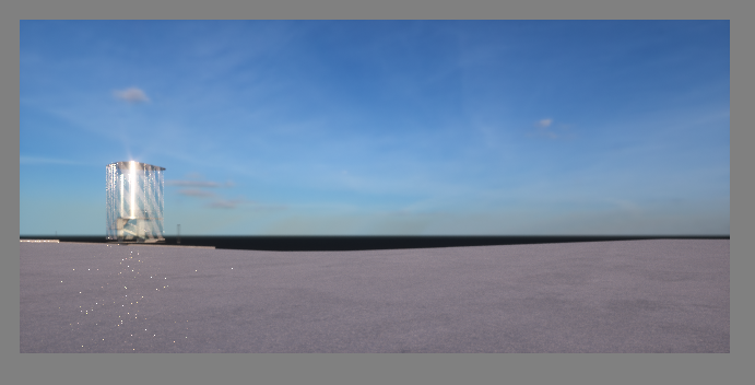

I had a look at your scene and they actually render the same in 2.24.2 and 3.00 alpha 2. The issue is that you probably render on many GPUs, I assume 12. In v2, the render results of the various GPUs got blended after tone mapping while in v3 we accumulate samples from the various GPUs in one film buffer and then execute the tone mapping with that one buffer, i.e. blending is done before tone mapping. In most cases there are no big differences, but in some situations there are. Your scene is one of those cases. Those glints in the floor are reflections of the reflection of the sun off the tower. GI clamp doesn't apply here, since it's a reflection of the sun via two mirrors. Due to the bump on the surface this happens fairly rarely, but when that happens its contribution is fairly large.
This is your scene rendered in 2.24.2 on 1 GPU with 2000spp:
and on 4 GPUs with 2000spp:
What happens here is that the 4 results of the 4 GPUs get tone mapped and with that clamped at 1. Then they get averaged. If one of the GPUs has a big contribution for a pixel, tone mapping will clamped it at 1 regardless how large it was. The other GPUs most likely don't have a big contribution at the same pixel and will have the normal floor value. Then they get mixed together and the pixel won't be much brighter than the floor, i.e. <<1.
In version 3 we have only one film buffer and if one GPU throws in a large contributions the average will become quite large, too, and will stay large after tone mapping.

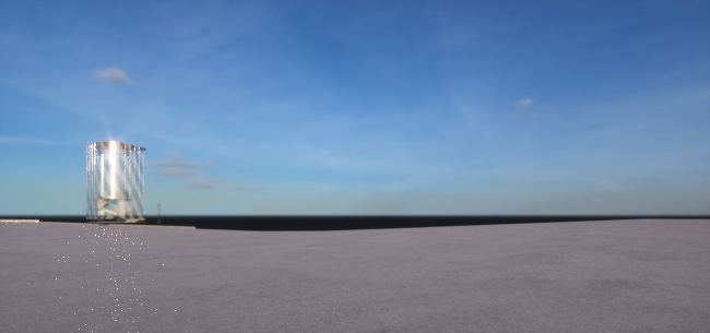

This is your scene rendered with 3.00 alpha 2 on 1 GPU with 2000spp:
So what can you do about it? Depends on what you want to do. If you don't want specular reflections on the floor, then make it a diffuse material. If you don't want the bump remove the bump. Or make the glossy material rougher. Also fix the IOR, which is currently 6 and doesn't make any sense. You basically have to fix your scene here.
PS: You might have noticed that I'm talking of alpha 2 all the time, that's because a bug sneaked into alpha 3 which broke the cosine mix material:
It will be fixed with the next release.
