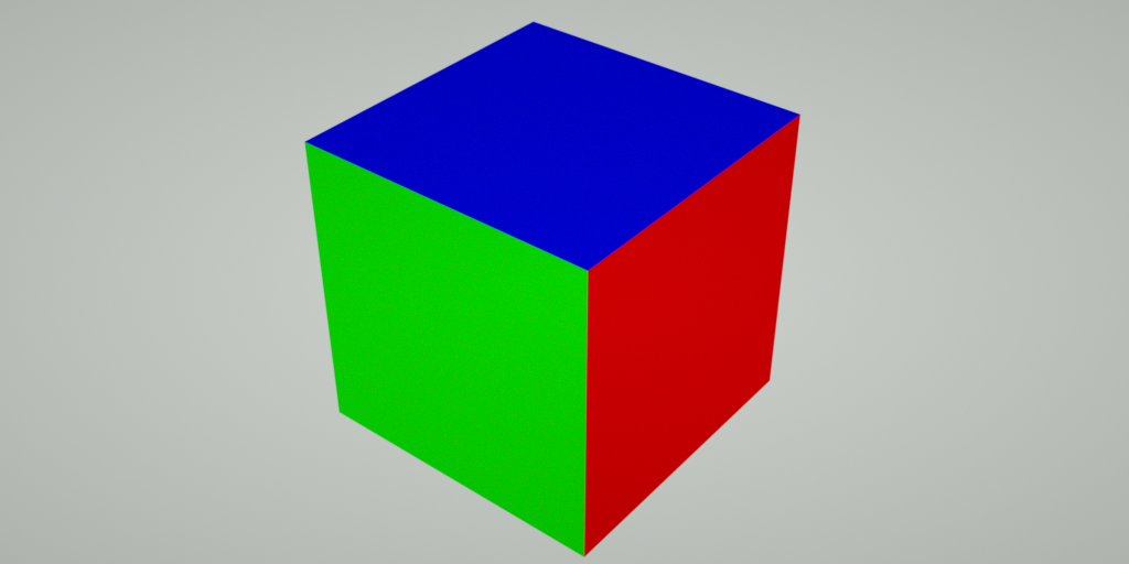

If you render your cube it should look something like this:
the cube created from Lua
