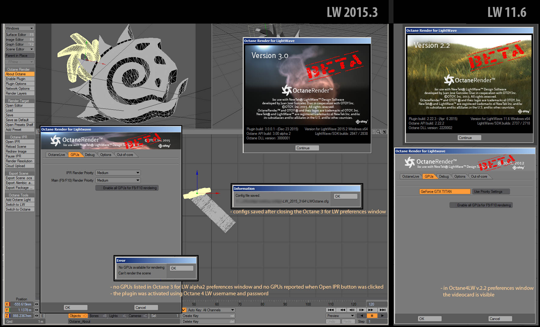

I do have a small problem with Octane 3 for Lightwave. The GPU is not visible for the plugin. The plugin was activated, but no GPUs. In Octane 2 for Lightwave the videocard is visible in the preferences window. I`m on Windows 7. Am I doing something wrong? The config folders are different for every Lightwave version installed. I also have LW 9.6 and my config files were always in separate locations, never had any problems with that. Any help will be highly appreciated. Thanks!
P.S. - Juanjgon, many thanks for all the work you`ve done for us. Cheers m8!
