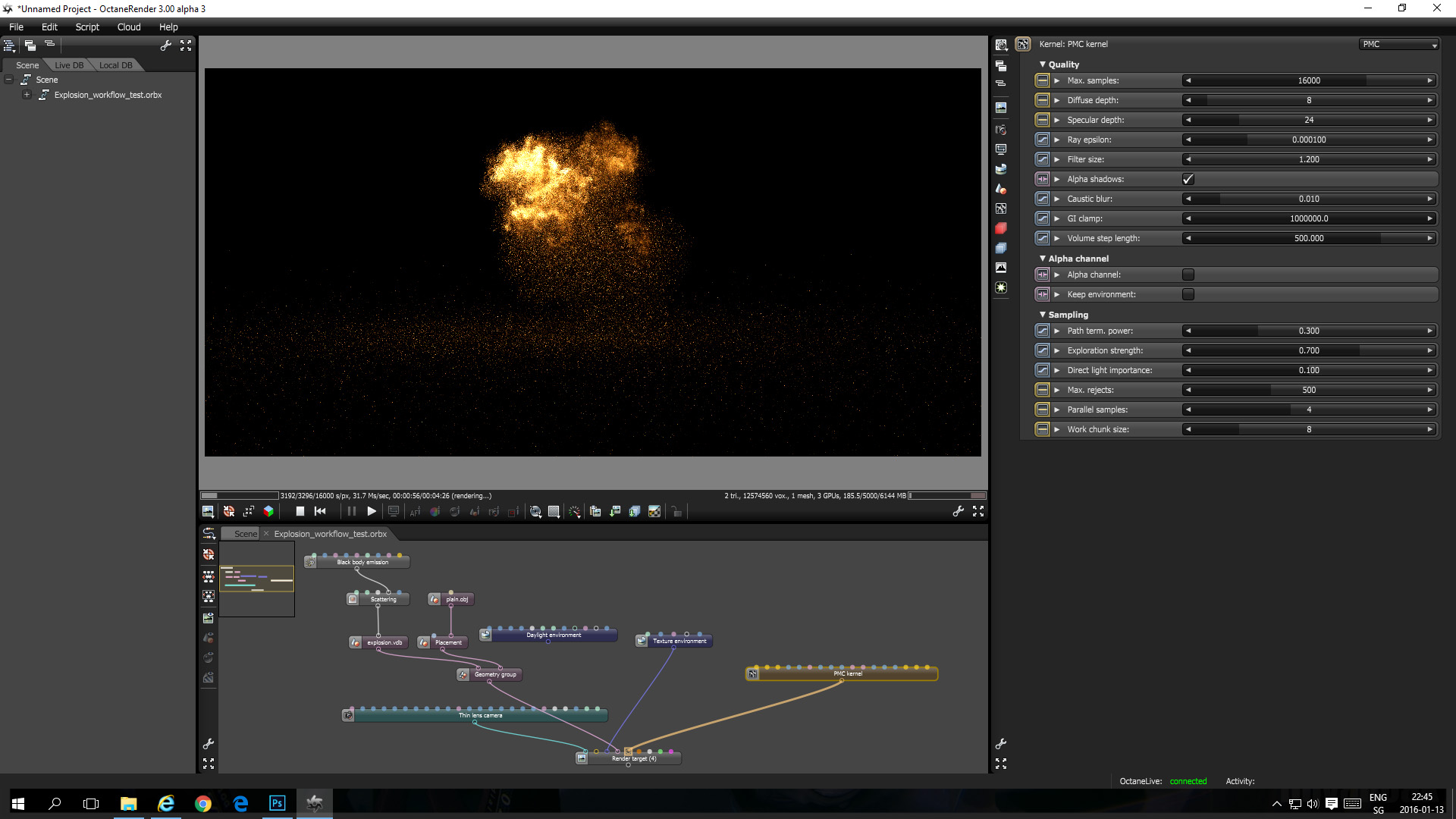

Thanks to all those who shared some test orbx scenes with VDB files.
I would have a lot of different questions and suggestions but at this point in time I guess I should focus on one point:
@ Volume step lenght
It seems the volume step length in the kernel setting makes a huge impact on how an imported VDB actually looks like.
It seems currently the volume step length can only be set on a scene level.
Is there any chance that the volume step length can be set on an object level in the future?
Example:
For explosion 1 a volume step level of 4 may give the wanted look.
For explosion 2 a volume step level of 90 may give the wanted look.
Basically the same VDB file could be used to create two different explosion effects in the same scene.
Side note:
To spin this thought further:
IF it would be possible to have different volume step lengths on an object level it might actually be possible to use cloud VDB as instances and then use different volume step lengths to achieve different looks for different versions of an instanced object while keeping the needed memory at the same level.
For that to work an additional requirement would be the possibility to assign different volume step lengths and material values to instances...
Test series made with the ORBX posted by uncia
viewtopic.php?f=33&t=51772&start=20#p259726
Volume step lenght 4
Volume step lenght 93
Volume step lenght 500
