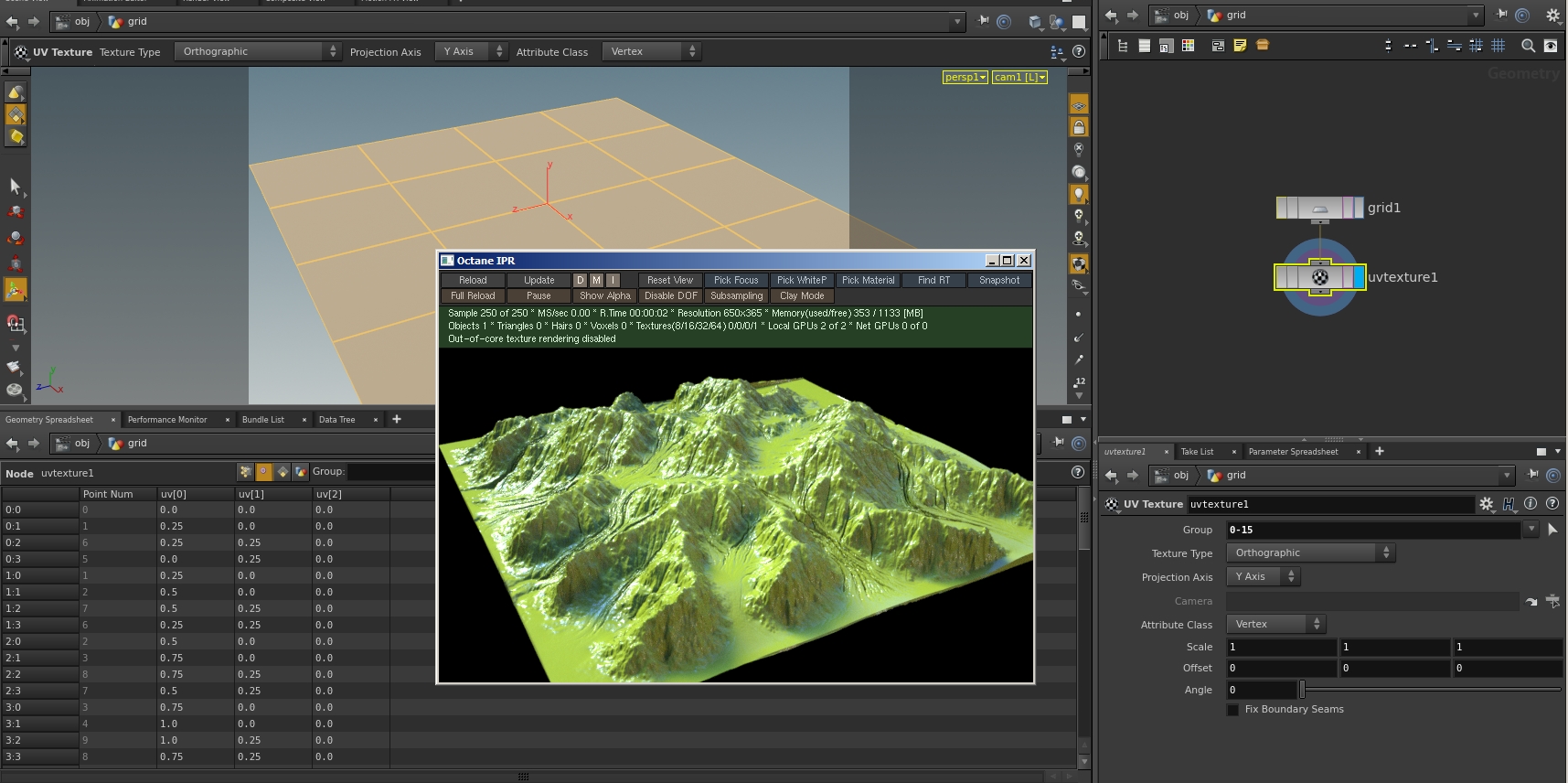

Hi Mate,
Just curious if Displacement is broken in 3.0, I'm just getting " *** OCTANE API MSG: This source doesn't contain any primitives!" when I try to render. Not sure if I'm doing something wrong.
File attached.

The problem is that displacement only works in Octane over an UV mapped object. You need to add an UV map to render your scene. The Octane projection node doesn't work for displacement.
-Juanjo

Ah thanks mate ;) That's awesome!
