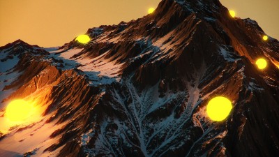

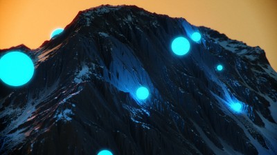

Maciek3d inspired me to check out world machine and very fun indeed! Here are a few of my first renders inside octane of a snowy mountain. (*edit. Guess forums don't like .tif. Re-uploaded jpeg version).
PT - 1000 samples
Post - AE
World Machine - First Renders
