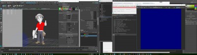

Hi, guys!
I have a octane render 2.24.1 and Octane for Maya 2016 2.24.2 - 7.14
I have a simple scene with a character and some objects. Every time there I hit the IPR my scene wont render just shouw (0.06 done) and the IPR wont start, and when i hit the render button my maya stop.

I had the same issue, and it was caused by to little ram.
The maya plugin never whines after more ram as standalone does.
If you have more system ram you can enable Out-Of-Core and that solved the issue for me.
This will at the moment just solve the textures, if it caused by mesh it cannot solve it by the Out of core function until v.3

OMG!!!!!!
Thanks Blackshore. You definitely saved my life. Many thanks
