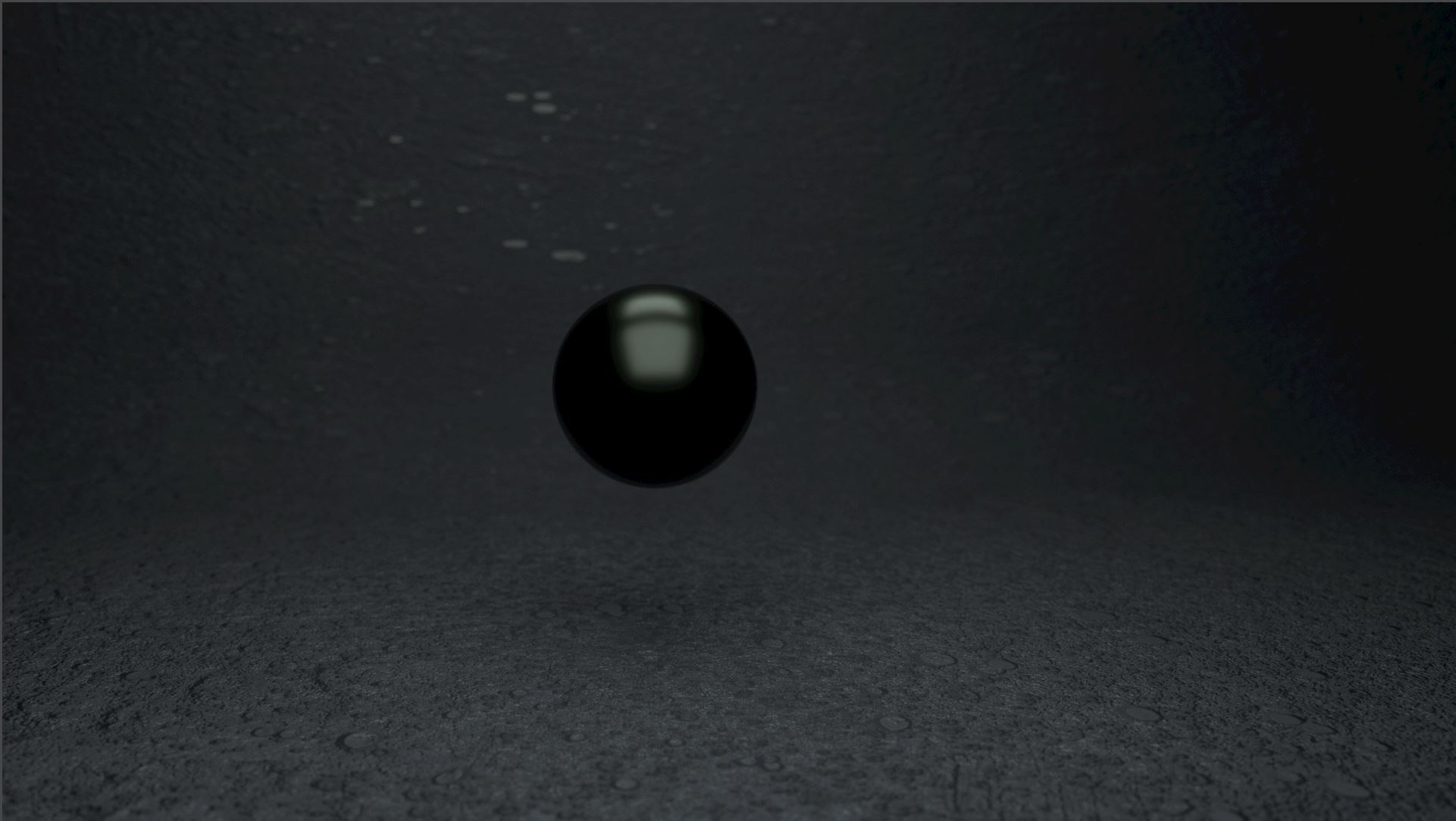

I'm getting weird color bandings around reflections and darker areas when I render in Picture viewer. I attached the screenshot from Live, Viewer and the settings.

I Also cranked up the ray epsilon. no luck.
I'd appreciate if you have any ideas.

I think you have render passes. So 8bit buffer is not well. Try floatbuffer (tonemapped or raw).
I keep that default because it's faster.

It worked. :) Thanks a lot.
