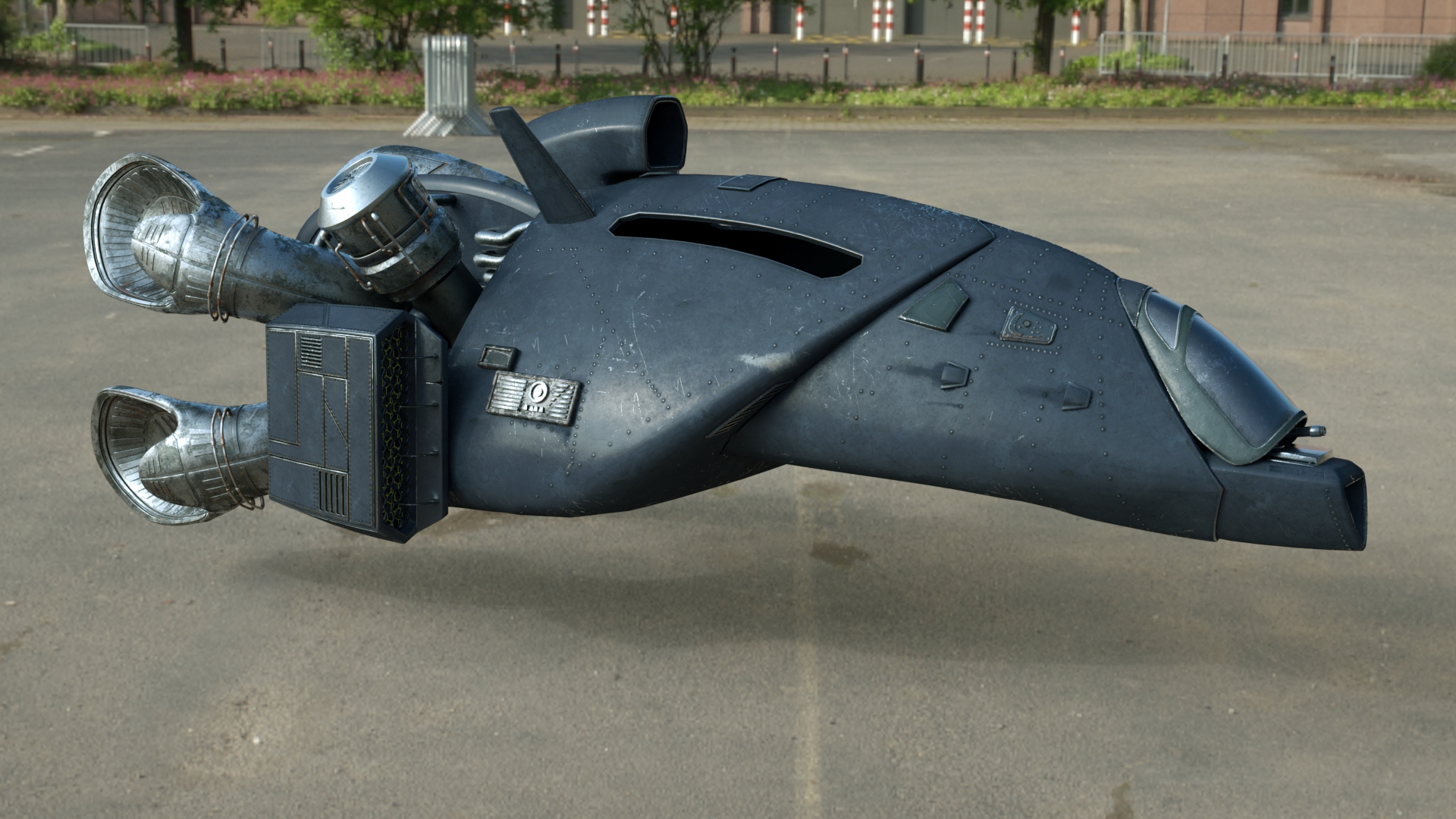

OK, I couldn't sleep so I had to try this. Firstly, I followed your steps pretty much to the letter. Then however, I found that plugging the inverted gloss into your remap gradient node was not working. It was kicking out an almost white file. This has been one of my bug-bears with the gamma in the LW plugin. Inverting a gloss, does not just make it a working roughness. I cannot figure out what your gradient is trying to do, so I reverted to my version which is simply.. Gloss texture at gamma 1, plugged into a colourcorrect node which is inverted and at gamma 2.2. It's the closest I can get to looking right. That all looked good, but the fresnel effect (which I'm guessing is the effect that can be seen at glancing angles? ) was present in what should be painted bits. So, I duplicated the whole set-up, removed the falloff node and just had the specular pluging straight into one of the gloss nodes. Used a colour correct node to make the specular basically black and white (I'm guessing a metalness map would be best for this in reality), and used that as the input to the material mix node. You can see there is no fresnel effect on the painted parts of the body, but it is on the canopy (which is some kind of metal (in my reality anyway :) )
What do you think Miko3d? Does it look any good? I've tried it on my spec/gloss balls array too.

Hey Gordon,thats looking pretty sweet :),
The roughness ramp on my shader is just a color remap,it has values every 10% so it is easy to tweak and have a close match when rendering in Octane.
I have not tested inverting the glossy (from the SRGB profile) and check if it is the same as the roughness from disney profile. They should match.

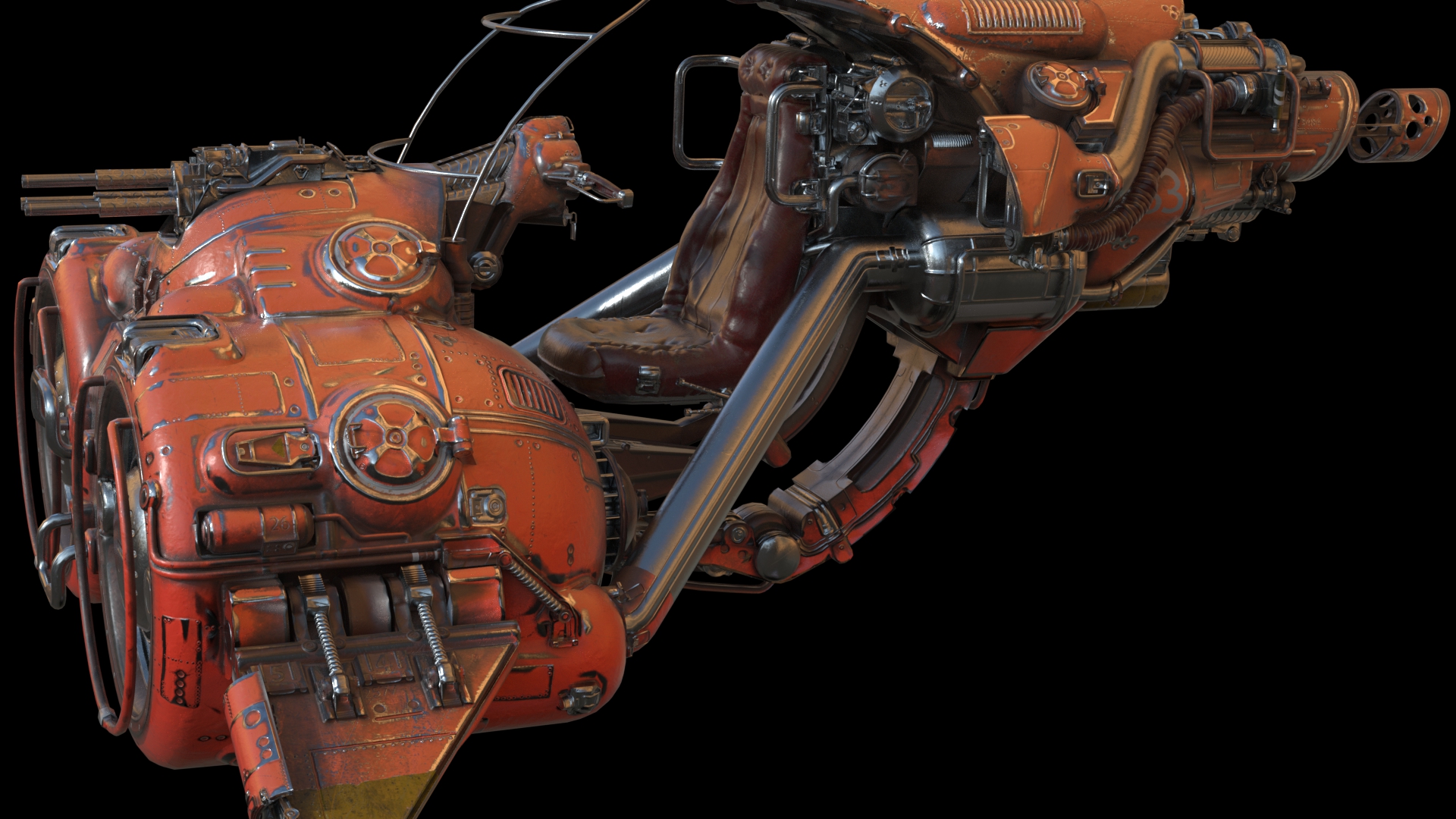

I've done some more work on it, and dug deeper into your shader. Would love to have a natter in the hangout if you're up for it.
I've simplified the shader, and added some other stuff from yours, but parts of it are still confusing to me :)
Here's where it got to today. This is rendered in Octane for Lightwave
