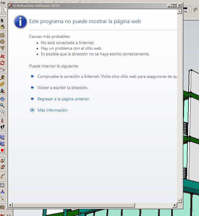

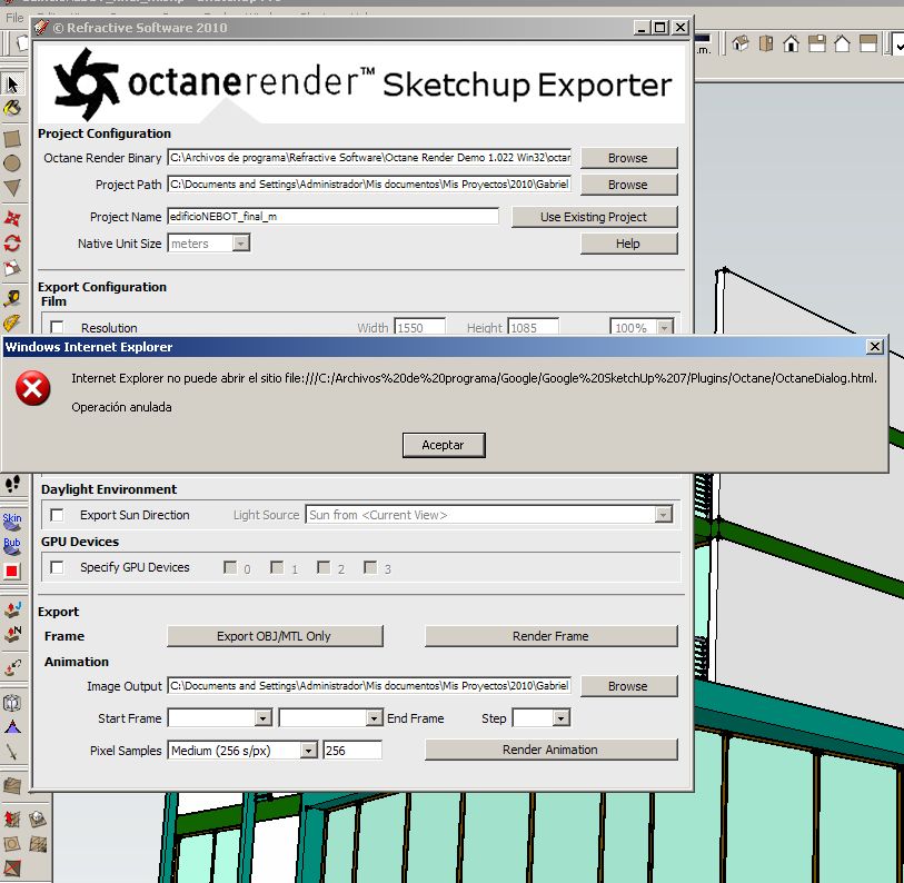

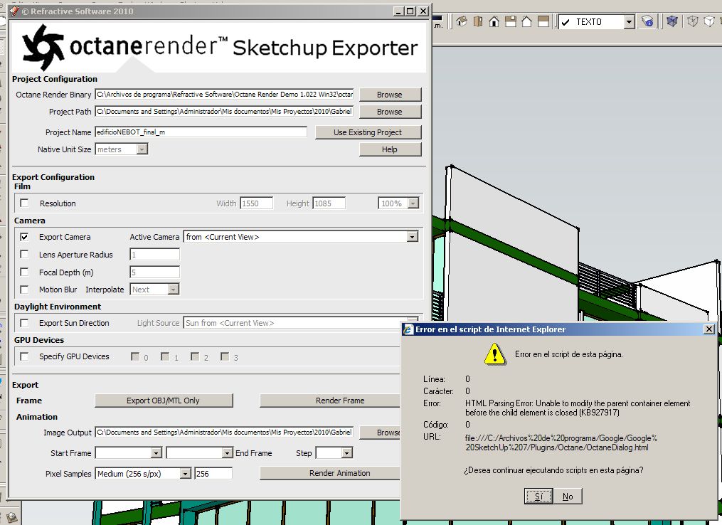

hi TTG! i think theres something wrong with my octane exporter u_u
when i open it this appears always (error1)
then i click OK or NO and when i close it and open it again i cant use it anymore
the second error appears and then i have to close it and open it again
i get the same error all the time but sometimes i can use it and sometimes i can´t
y just decompressed the contents of the zip on the plugins folder, i hope i didn´t do anything wrong!

This might be because the sliders on the dialog use a yui slider widget that is accessed off the Internet, once it's downloaded it's cached and should work thereafter... I am looking at ways of 'hard-coding' this into the tool to avoid such errors. The last parent/child error [1] seems related to that and if you say 'Yes' and continue the dialog should work without the sliders... Do you have IE7 or IE8 ?
I don't understand the other errors as IE [the basis used by the js in the SUp ACI web-dialog] doesn't seem to be finding the html file but t's displaying it ? Presumably the file it list is there [the '%20' code is a space in html]. You did keep the files in their sub-folders ? as listed in the zip and README / Help file ??? Check that you do NOT have any of files in Plugins, that shouldn't be there...
What OS do you have ? What version of IE do you have ?

i just extracted it as it came into the pug ins folder, i know i shouldn't extract the folder because those ruby's that are installed call for what the folder has inside :) i don't know anything about programming :P but i think it works like that.
i am using win XP 32 and IE8, and i click yes and apparently everything works fine but haven't tested it completely yet because of my computer, i am expecting the new one in 3 weeks, that one will have win7 64 ultimate, i hope this doesn't appear anymore with the win7, and i will start practicing octane with my licensed software as soon the PC arrives, i just don't want to install octane on this one because of the PC lock the app has.
sometimes this error does not show after 3/4 times i close and open the exporter window, i hope this helps.
