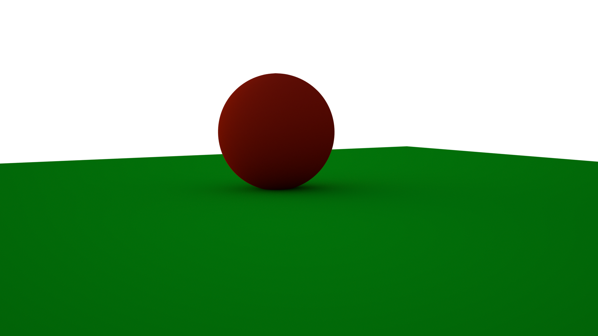

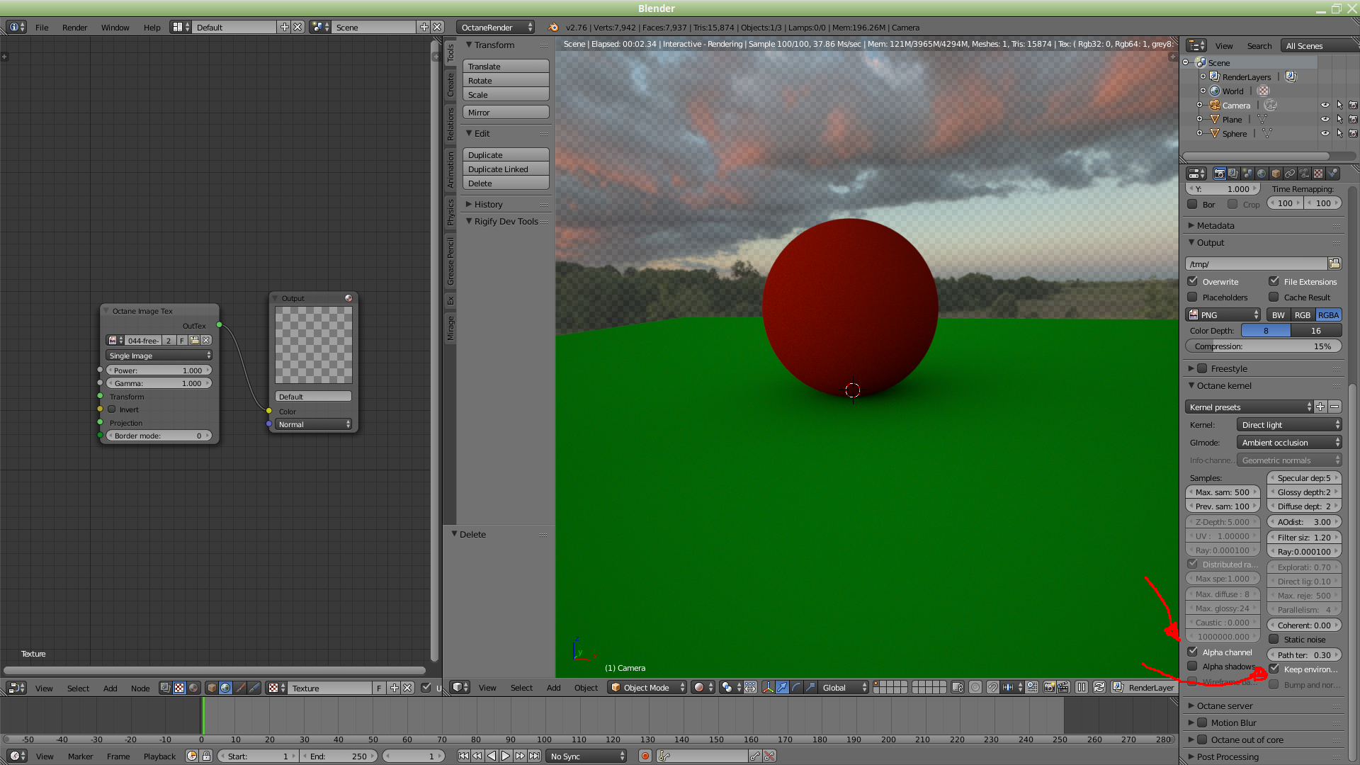

That's really strange because the Blender plugin can do it, and the same settings are used that aoktar specified in the thread I linked to.
Here is the rendered file so you can check and see if it works for what you need:
Here is the scene rendered with the hdri not set to alpha:
Linux Mint 21.3 x64 | Nvidia GTX 980 4GB (displays) RTX 2070 8GB| Intel I7 5820K 3.8 Ghz | 32Gb Memory | Nvidia Driver 535.171

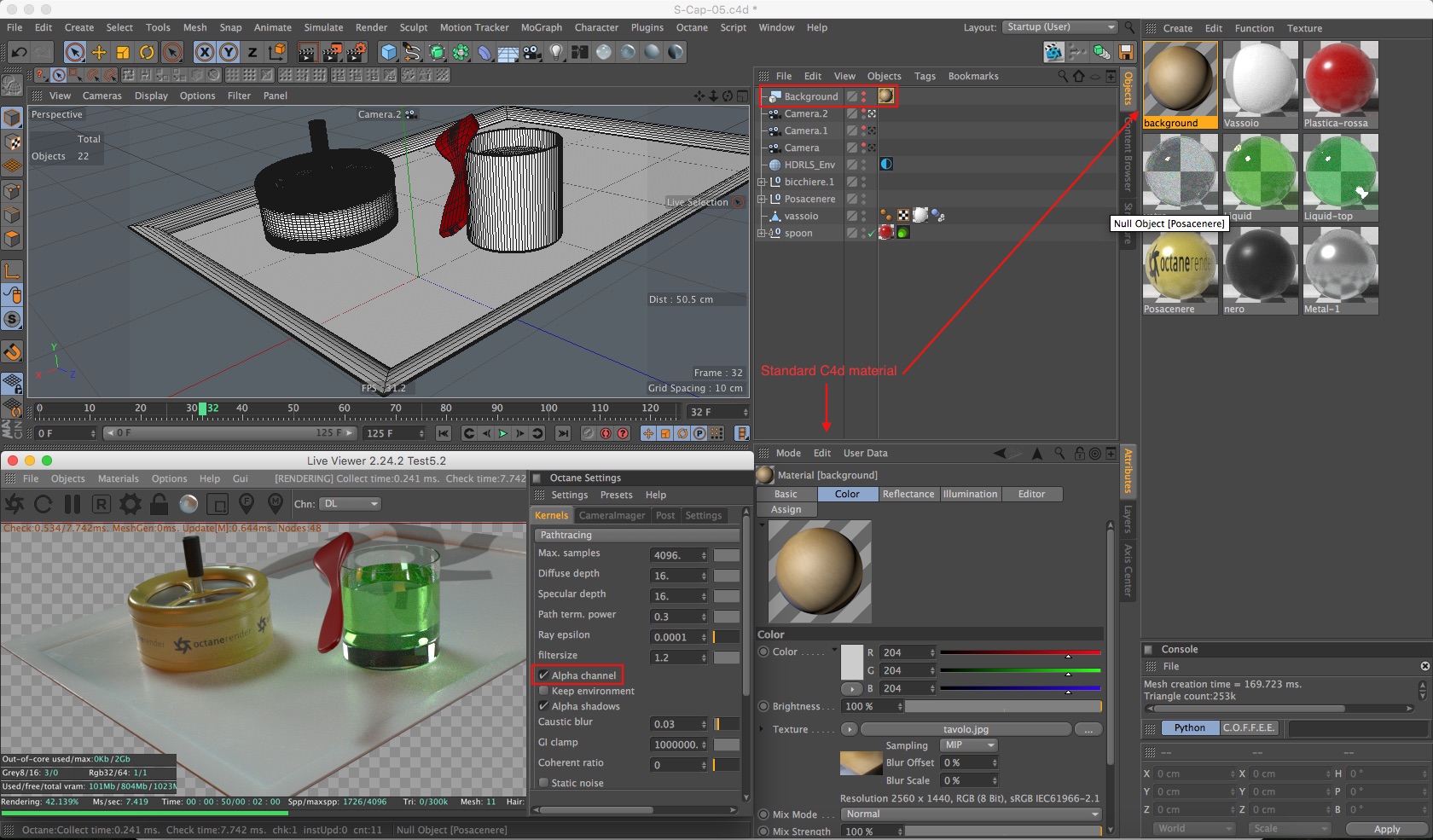

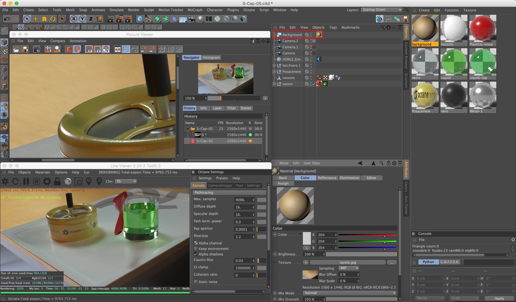

Not in standalone, but since aoktar is a smart guy, it is possible within the c4dOctane plugin ;)
The trick is to add a c4d background object and assign to it a standard c4d material with the proper texture in the color channel. Then you can see and render the full fram in both Live View and Picture Viewer without having to compose it later on ;)
