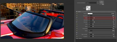

Example: I try to render a car model which I have bought. I use a simple specular shader for the windshield, nothing fancy.
Since the model has simple polygon plane wihtout thickness, refracted rays don't get back to the angle they hit the glass, because they think they are still in the glass. Which is computationally true.

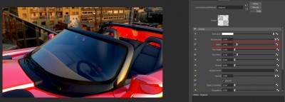

Now I set the index to 0 to compensate the refraction, but this time I have lost all the reflection as well.

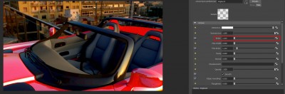

I have extruded the glass. 0.01 units. Now everything looks fine.
