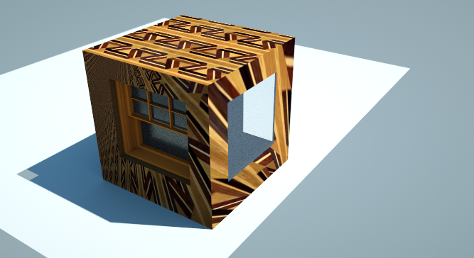

Here's a quick movie I made form the animation scenes in the zip - I know the quality is low and there are too few frames but it only took a minute to make... but...but...but...
Movie.wmv
(311.11 KiB) Downloaded 6382 times
There's also a higher res still of frame1
TIG
